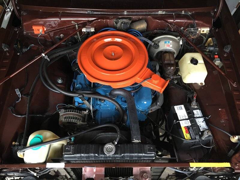

Stock 1970 318
Edelbrock Performer intake.
Edelbrock 600cfm carb.
340 Hi-Po manifolds.
Dual exhaust/H pipe
Chrysler Electronic ign.
Chrysler 4bbl kickdown.
This was an older set up I put together, and it would roast the peg leg all the way down the street.
