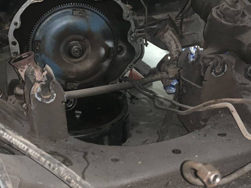

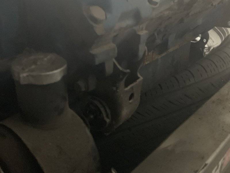

So I have these motor mounts I'm pretty sure they will work for my situation I have a 73 up slant 6 K member wondering how these get oriented on the engine block

vegasanthony, do you have completely stock 73-up k-frame or has it been modified already?
The driver side engine mount extension on the k-frame will be longer than the one in Noahschreck's photo, and the instructions would tell you how much to cut it down and drill the new hole.
Edited to add photos.
View attachment 1715346147 View attachment 1715346148 View attachment 1715346150
Now things make a little more since I started this other thread on the suspension forum. K member steering box doent line up?
So it looks like the modification was done but in trying to reinforce the steering box or something the guy got really sloppy
