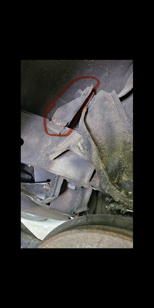

Nihms Member Joined Nov 6, 2022 Messages 21 Reaction score 16 Location Tennessee Sep 11, 2024 #1 Can anyone tell me what this part is called and who might have a replacement one? Had a crack running thru it.
toolmanmike Moderator and forum fixer Staff member FABO Gold Member Joined Jan 18, 2006 Messages 88,691 Reaction score 103,671 Location Office Sep 11, 2024 #2 Upper control arm bracket? They don't make them as replacements. Just prep and weld the crack. They are welded onto the rail so welding is necessary regardless.
Super-Cuda MOPAR .. Move Over, Plymouth Approaching Rapidly! Joined Nov 5, 2014 Messages 5,045 Reaction score 7,253 Location Canada Sep 11, 2024 #3 Nihms said: Can anyone tell me what this part is called and who might have a replacement one? Had a crack running thru it. View attachment 1716301882 Click to expand... Here's the replacement part available at Classic Industries. Upper control arm mount, part number MM8186 Cheers!!
