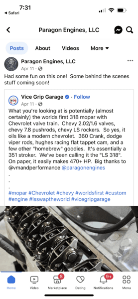

Just came across this last night, thought I’d see if anyone has an inside story on it. The details starts at the 40 minute mark. Looks like some spendy custom machine work to be "budget..."

Pretty sure at first that the heads have have the engine guys name lasered into them, but can’t tell for definite now. They do look like a Trick Flow casting.
Etched in to the front of the heads it says “Paragon Engines” not trick flow Or edlebrock. That’s one of the things I zoomed in on while watching it. Ill bet money they’re speedmaster heads that his machinist milled the stands down on and made the rail for the LS rockers.
And one more screen shot. Hopefully some follow up from them in the future.
I looked again, what I saw on my small screen 1st time was at what i see now is at 51 min in. The font and being two words looked like Trick Flow to me on my small screen. But looked again and few min later on a real TV screen and clearly is not.
