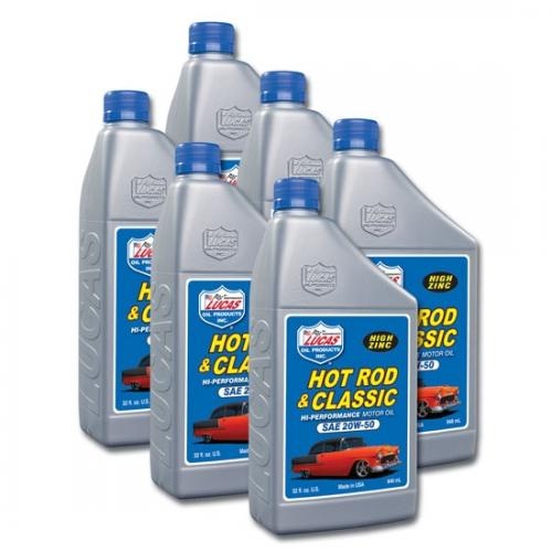

Lucas is already here and the right weight. Another option of course is ordering VR1 from Summitt
Lucas has a great reputation. I wasn't even aware they made motor oil. Summit has their 10/30 for like 25 bucks for a 5 qt container. That's not bad and it is ZDDP enhanced too.

Lucas Hot Rod Oil
