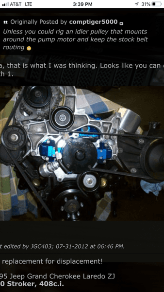

Hi yes I will be useing the stock Alt bracket. I have been told the electric water pump wont work with the stock mount. But found a pick of wear one guy made it work. But he was running power steering. My friend that I got the engine off of ran the stock Alt bracket, with a mod stock water pump. He fixed it so that one of those electric motor kits ran the stock wAter pump.
I am wanting to go to a full electric water pump because I am having a hard time finding a electric cooling fan, to clear the stock water pump. Here is the pic of the guy that got a electric water pump to work with the stock brackets etc

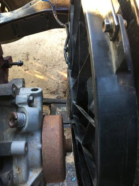

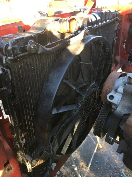

Here is what it looks like with a stock water pump, stock rad and a electric fan off a 99 Jeep Grand Cherokee.

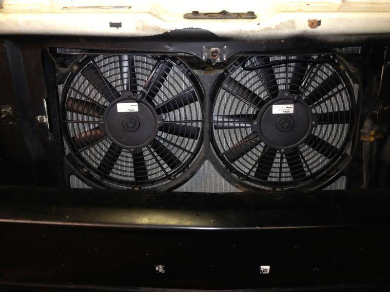

Have you considered using a pusher fan instead? FWIW the 89 shelby dakota's used 2 -11" pusher fans sandwiched between the radiator and the condenser.
