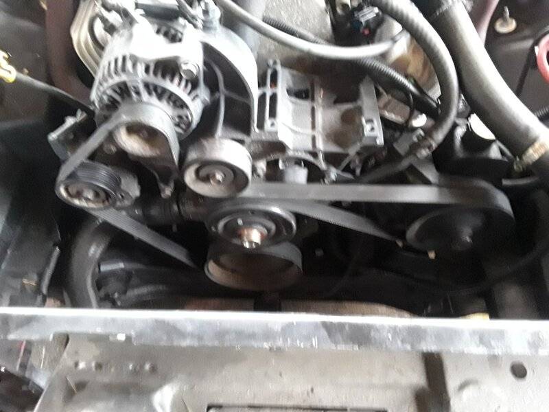

Here is an example of what happens when an AC bracket is used without an AC pump but with a PS pump:
Now this may only be with the van PS bracket, I guess it puts the pump lower than the truck or jeep setup. Not really sure.
Here is the thread that came from - Van power steering bracket issues
Guessing I'm not saying it right. And not really following what you are saying.
That's what I thought you were saying. Van issue because of the power steering being lower than truck. I'd use truck stuff. You only need a shorter belt. Like 97 inches.
That's what I thought you were saying. So let me be clearer you use a different belt.
Gotcha. I've seen a different routing when there is no AC and no PS, but no idea what routing would work with no AC but with PS.
To be clear, it does appear that the higher PS mount from a truck or Jeep does seem to avoid the issue. I didn't realize that until I re-read the linked thread. So technically, the issue only comes up when running the van PS bracket.

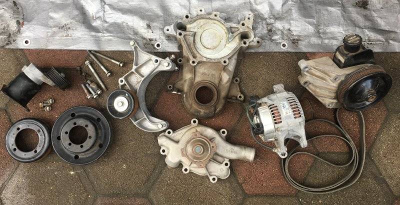

In other words get the complete front caver setup including accessories like the alt, p/s pump, a/c if you run one as you will need all brackets, pulleys, bolts, etc...
I recently purchased the complete front setup from a member for under $100.
