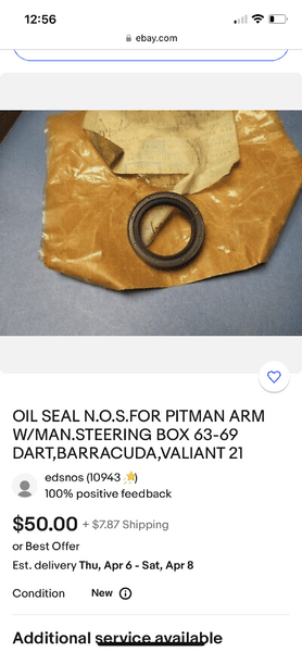

eBay. Price seems ridiculous but it is available.
price for NOS would be higher but... source a shaft seal from a industrial supply company per the dimensions required should find it for less.

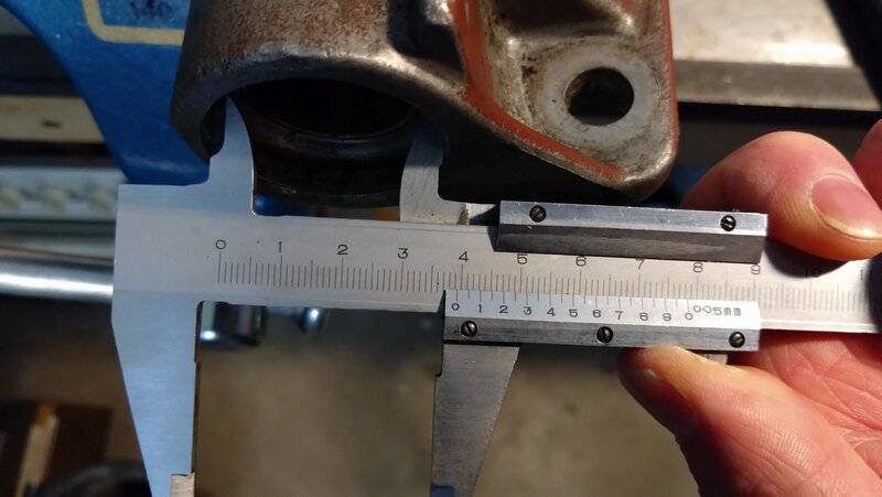

Many thanks to you all for your answers. But problem is that national seal 6859S is not correct. I have that seal. To be clear Steering gear is original -64 Dart manual steering. And sorry for talking millimetre measurements, I don't have inch gauges. Outer diameter of seal is 43 mm and housing for seal in steering gear has 39,35 mm diameter. Seal inner diameter is 29,55 mm (not pushed wide very gently measured) and pitman arm shaft diameter is 28,55 mm. See attached pictures.

divide metric by 25.4 to get inch. So your shaft diameter in metric of 28.55 divided by 25.4 gets you a 1.125 (1&1/8") shaft diameter.
SKF 11067 seal is close to your measurements. It can be difficult to get exact measurements on a used seal. Considering the low price , it might be worth a try.
