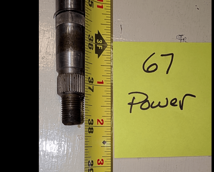

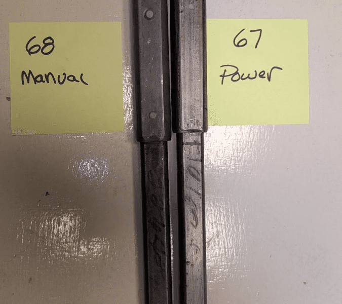

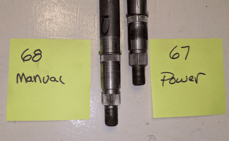

I needed to swap shafts on my67 Dart #2, I'm going from power to manual (I did not want to use an adapter) so I documents the shaft lengths and details.
67-69 A bodies... (70 starts a different set of part numbers AND this does not cover the BB specific shaft for 68-69)
Steering shaft (Section 19-15-4)
Manual Steering 2880169
Power Steering 2880170

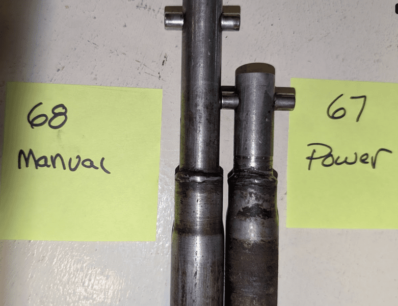

Steering wheel end lined up
Notice the lower shaft is shorter on the PS vs the Manual not just the length of the bottom with the cross bars

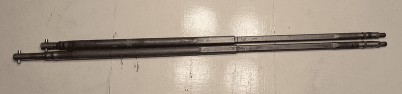

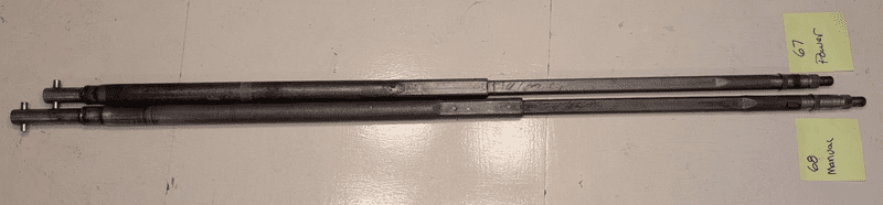

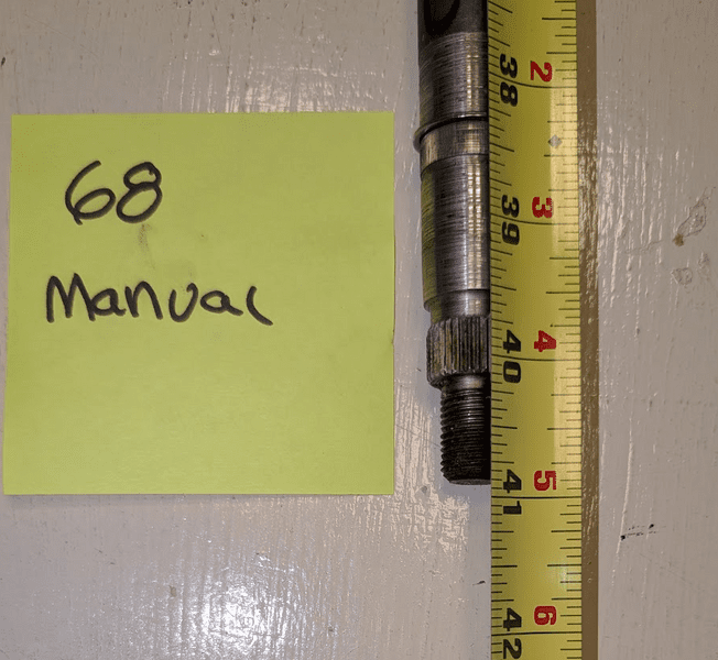

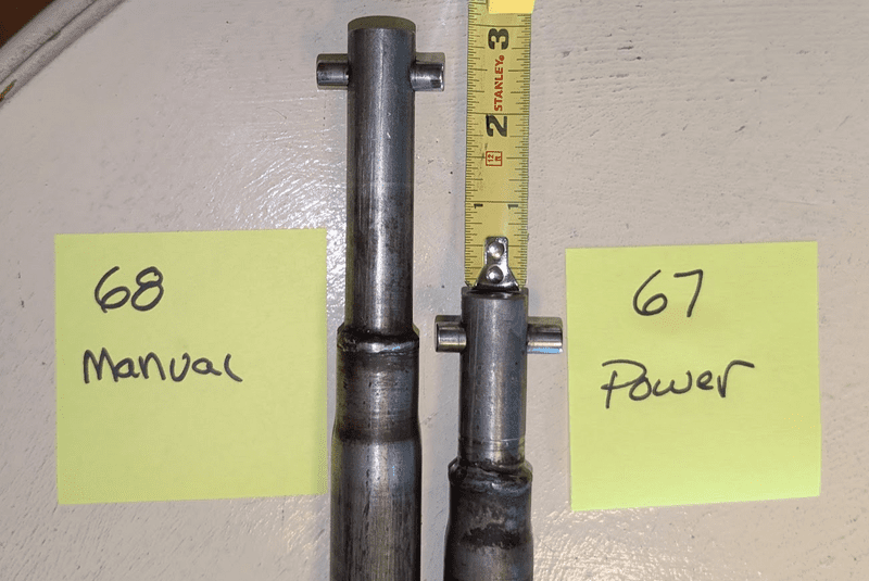

Overall length
Manual Steering
Power Steering

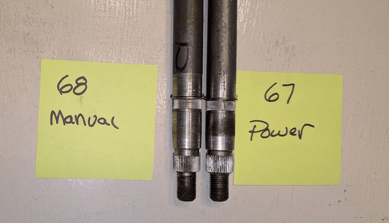

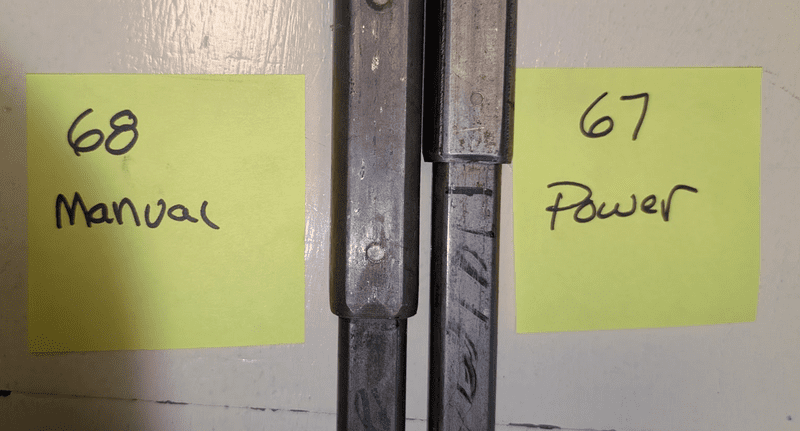

Taper / weld on the lower shaft lined up (and no you can not just drill a new hole the other end will be short)

In taking the 2 columns apart I discovered some differences..

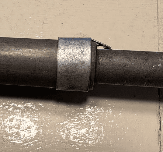

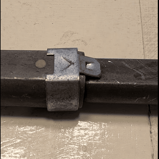

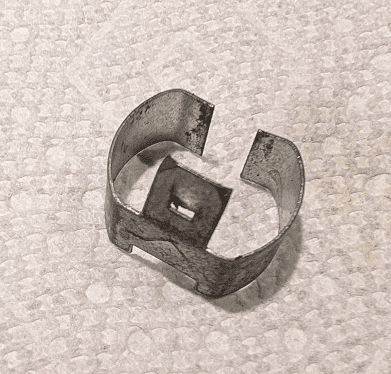

  2. I found a steering shaft ground clip (Section 19-15-04 PN6015501) in the 67 column but not in the 68 column (see photos). The parts book still calls it out in 68 but did they add a ground in the turn signal wiring in 68 up?
  3. The obvious lower shaft bearing
With the brake away plastic separating the upper and the lower shafts, it looks like they though a ground clip was in order. This clip makes a ground path from the steering wheel, to the steering shaft, to the steering box, to the frame.
And this is with the plastic shear pins intact, correct? Someone will ask, so it may as well be me...
yes absolutely UNMOLESTED columns, never apart that I could tell and I never had a hammer within 25 feet of either when I took them apart on the table. I even made a puller that functions similar to the one in the FSM.

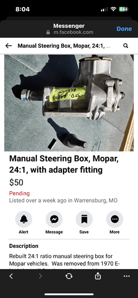

Thanks, for the good info Dana, I never did want to modify my PS column. It seems like alot of work. Also I'm not sure of the final configuration steering wise, but I do know that, I do not like the sloppy Mopar power steering. My box and pump leak and eventually, I'll probably go with Borgeson, but it's not in the budget now. I made a deal for a used box with a member here and picked up an adapter from Mancini.

I'm not opposed to using them. It just a matter of economics, at $131 plus shipping being the cheapest and up to almost $200 the ones, I've found, it just seems ridiculous, but these are the times.
Can i ask why you dont want to use an adapter? As about to purchase a manual box for my one and going to use an adapter that comes with the box. Is there an issue with the adapters?
There’s no issue with them that I’m aware of? I’m doing the same thing this spring. Luckily I was able to buy a used PST box and a new adapter for $50.

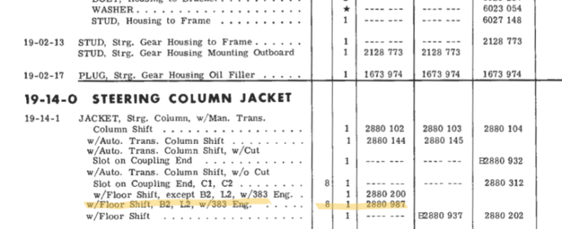

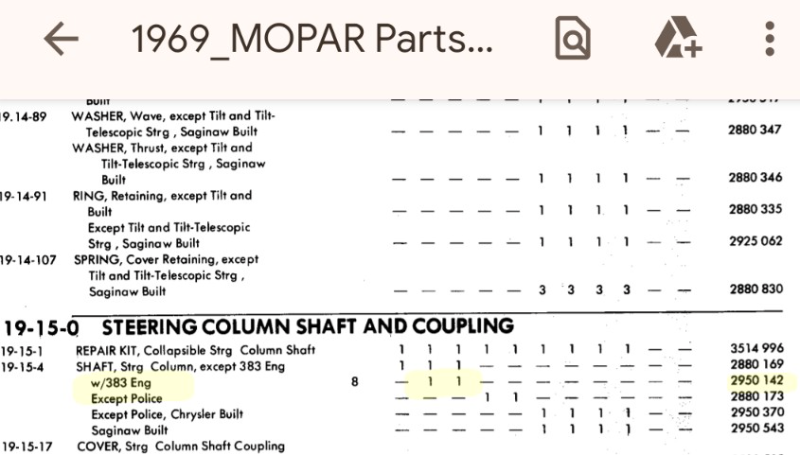

Does anyone know what is the difference between the 67-69 big block steering shaft and a non big block shaft is?
My understanding is the 67 outer column is the same as all other engines, but in 68-69 the outer column got shorter for manifold clearance.
My wording was not clear in the post you referenced. The steering shaft would be the same but the outer column would bevdiferent

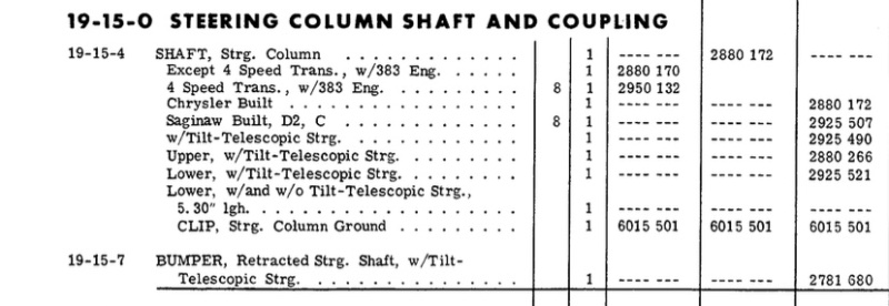

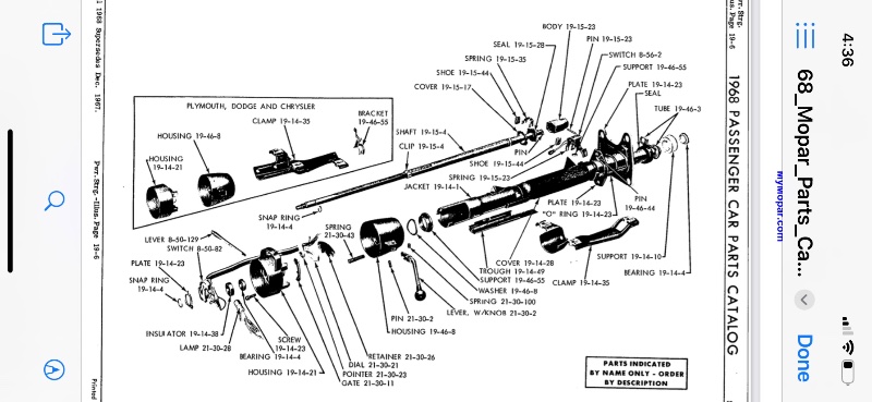

When you asked the question I thought oops I was referring to the outer column ( jacket) So i looked again. At least in 69 there is a BB specific shaft but not a BB specific column ( jacket)
no BB specific column (jacket)
1969 parts book
I checked 67 parts book
Only one manual steering shaft for all engines (power was not an option w BB in 67)
But the column ( jacket) is called out with a seperate part for BB
As for differences, you got me.

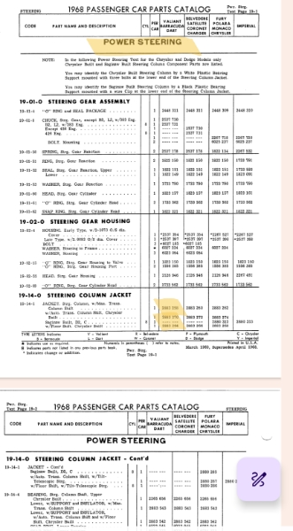

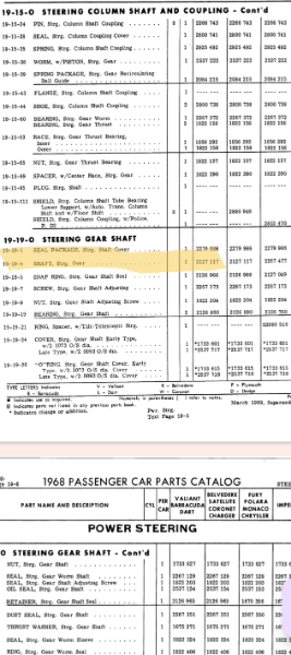

I believe the ‘68 parts manual is not correct. It only calls out for one shaft for the non 383 Valiant and Barracuda. It doesn’t differentiate between manual or power steering for shaft 19-15-4.
Check again. The 67 parts book has a section for manual (standard) and power basically a copy of the manual section but with extra photos and part numbers for the power parts
68 power section
