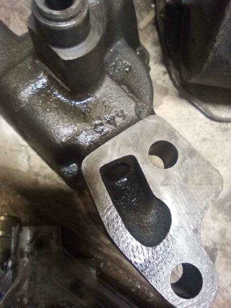

just thought I would put this out here this is a pic of a melling pump that i got when I bought an engine it was bolted on it but the motor didn't even make the brake in
Sounds a little strange but I go through all my bb oil pumps, I open the corner passage going to the oil filter, there never drilled 100 percent. I open and blend openings under the filter. I’ve used Melling pumps for many years but I have never understood why there machining is so half ***.
Add more pictures showing the rest of the pump. I am wondering if this is an Amazon or eBay copy or a real Melling pump. Either way, give some details too. Are you saying the engine this came on failed during break in? What kind of failure?
There is a gasket that goes between the pump and the block.
Use it.
If you can’t find a paper gasket, Schumann oil pumps has dead soft copper gaskets.
Either way, use a gasket.
I never ran a pump on a small block without a gasket. You can buy the paper thin material at NAPA. Set it on the main or pump and used a small ball peen hammer and lightly tap around all the edges . You'll end up with a perfect gasket. Use the old pump if you are buying a new one.
IDK but it looks like teeth marks from a vise. How about a picture from the back side of the pump, are there marks there as well.....?
that's what i thought too. looks like somebody clamped that bad boy up to wrench on the pick up would be my guess.
Yeah someone gave that a nasty squeeze lol. All for the sake of what $40-50??
