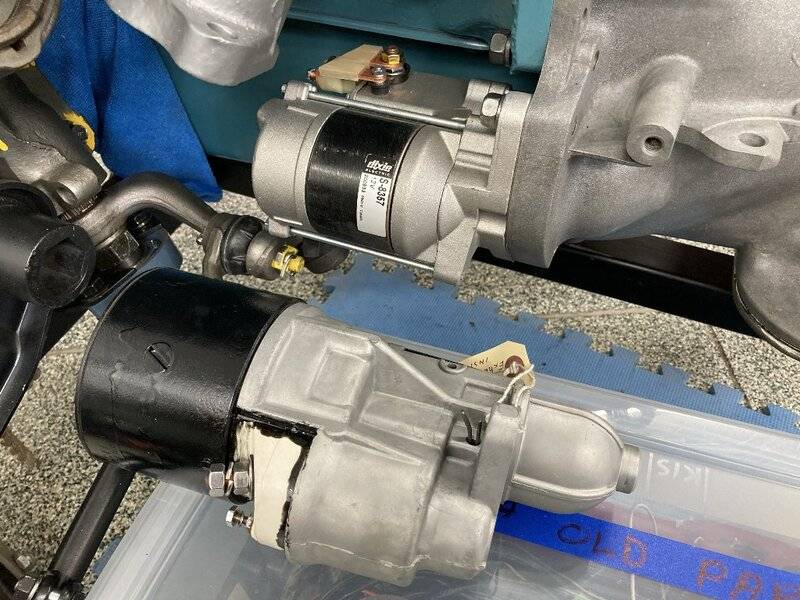

Was installing the tranny and a mini starter today. I bought a terminal extender kit to move the connection points for easier installation. BUT, this extension kit does nothing to help the connections!!! It may work OK on a big block tranny, but I wasted my money on buying it for a small block!!! The starter cable will connect just fine to the original terminals.

View attachment 1715692864 View attachment 1715692865 View attachment 1715692866
SAME HERE -BIG BLOCK THO .
Here is the issue with the big block. I shortened the larger lug and didn't use an adapter.
Guess I'm in the minority but the kit worked for me. I have Schumacher Tri-Y headers on my 340 and without that kit the connections would have been very awkward to get to.
