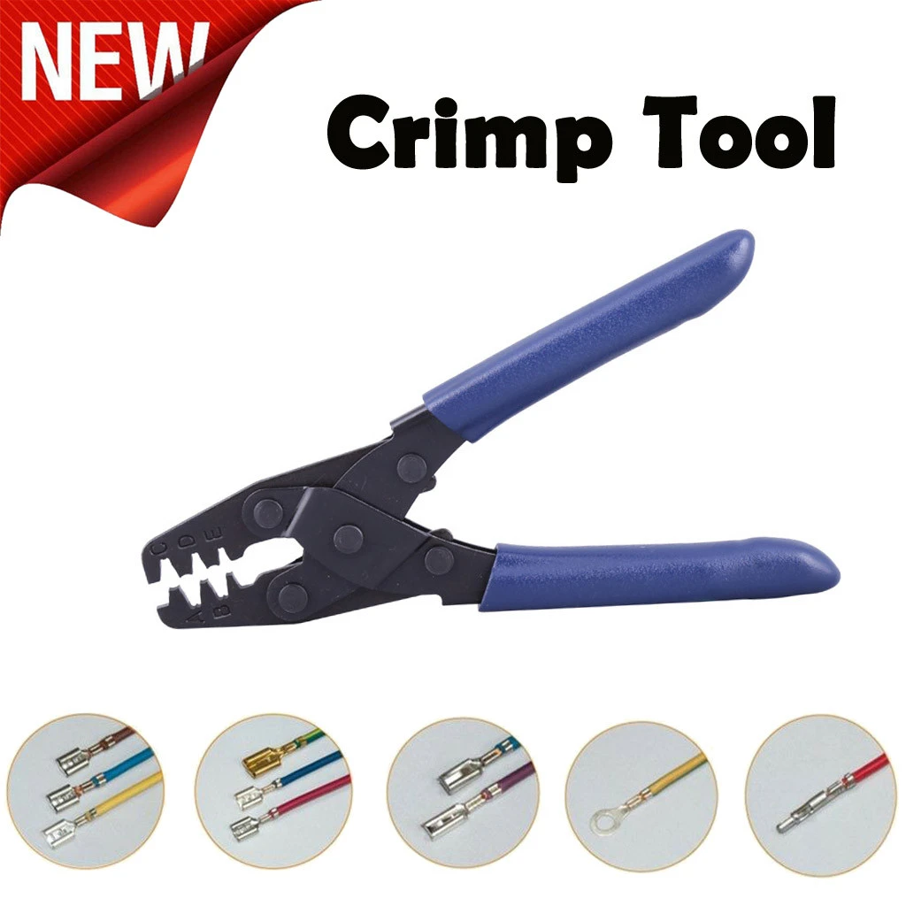

I can't see what you're working with, but a generic "open barrell" style crimper should work. Just pay attention to make sure the wire gauge you're using matches the range that the pins will accept, and then use the correct position on the crimper for that range. This might help: How to Crimp Open Barrel Terminals | www.iwiss.com
I used these at first a bit user unfriendly till you get used to them. Under $30
Molex-Style-Crimp-Tool-Wiring-Harness-Crimping-Crimper-Open-Barrel-Kit-10-22-Awg-Manual-Cold.jpg_Q90.jpg_.webp
