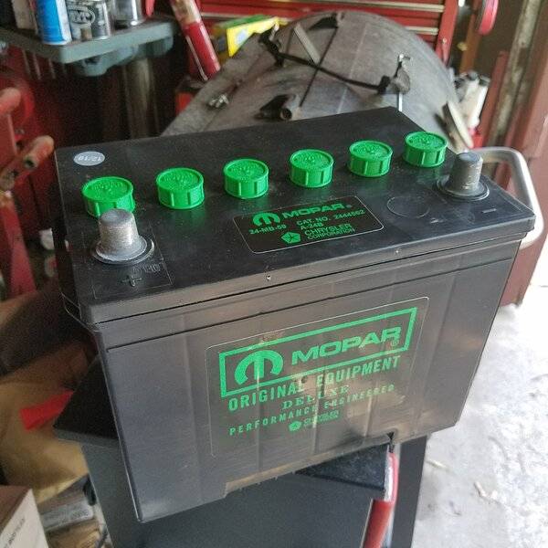

Yes, the newer batteries have 3 hole vent caps on them. Not screw on but push on's.
Here's a example. The caps just pry off and the stickers will just peel off.

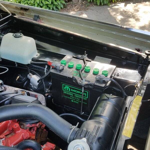

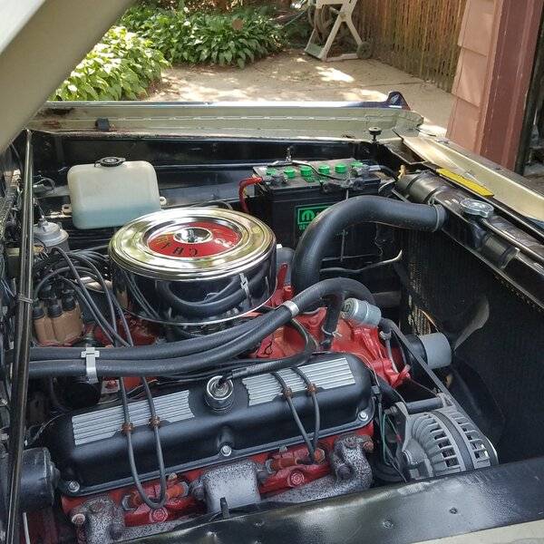

I got the kit and installed the caps. I will install the stickers later. A winner so far.
Got the stickers on. Looks right at home in there. Not bad for a $25 add on.

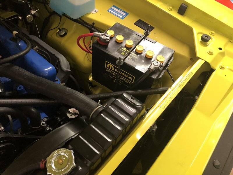

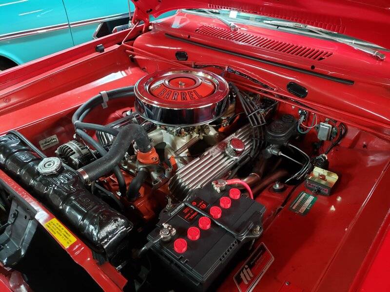

Yeah, I got the stick on cap kit for my maintenance free battery from NAPA. I didn't use the OEM correct colors, though. I used the red decal/cap kit to match my red car. <g>

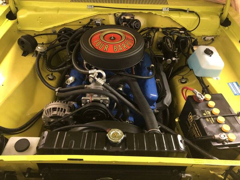

Just finished up mine. Getting the glue residue off was the hardest part with the old stickers. I went with yellow since you couldn't get a 340 in a 1971 Dart unless it was one of the few Canadian built cars plus my car is far from OEM.
