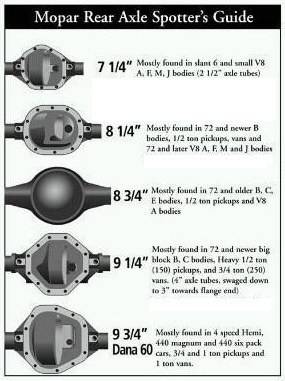

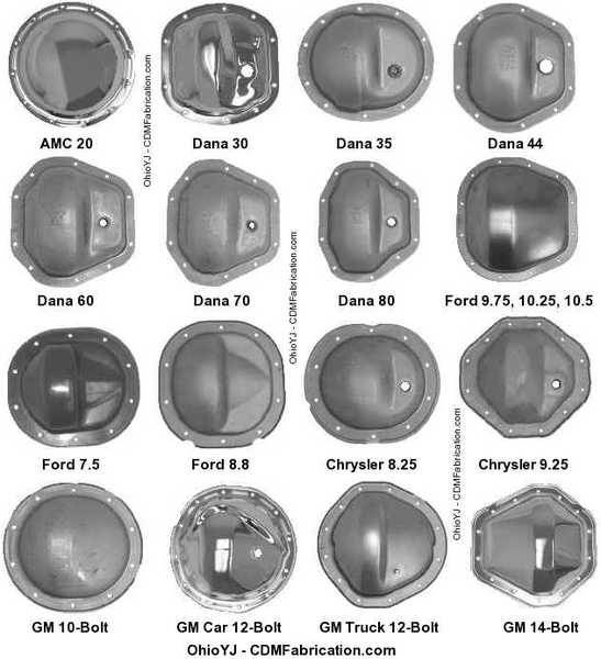

Get a picture of the cover plate on the back of the center section....
Probably an 8.25 which WILL NOT fit your 65 without a lot of work to the rear end
I have no idea never saw a flat side to the pumpkin with a tube out of it before.
It appears to be a B body 8 1/4, but it's a terrible picture for identification. If it's a B body axle, it will have to be heavily modified to fit in an A body. Narrowed, spring perches moved and "all that".

That one there definetly looks like 8.25.
im sorry for the bad pictures, its the only one he send to me. thanks for the answers
It's ok. Maybe you could get him to send you a picture straight on from the rear cover......but I wouldn't worry with it. There are more choices that will actually fit your car.

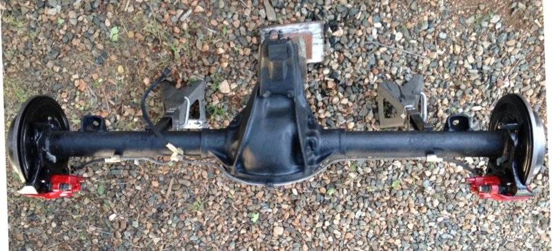

That's definitely a 70's 8.25. (note the two ribs on the housing like your picture)
You would have to have the tubes shortened and get new axles plus move the spring perches before it will fit your car.
On the upside, Jeep Cherokee's and lots of other newer 4x4 vehicles have sure grip units that fit in those cases. (I know because I just did one)
Those same vehicles have gear sets in the 4.10, 3.55 and 3.73 range commonly and cheap.
THEN even the disc brakes from the Grand Cherokee or Liberty bolt right onto that rear end.
The carrier bearings are different between the newer Jeeps and these early 8.25's but they are easily sourced, and I have the part numbers for them from when I did mine.
I also had to get longer wheel studs because the rotors take up more of the stud than drums.
This is a 1973 8.25 Abody unit with Jeep Limited slip and 3.55 gears with Grand Cherokee disc brakes.
It's in my 73 Swinger right now and I'm really happy with it.
