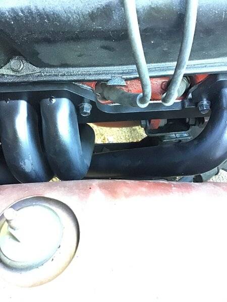

I think my motor mounts are switch over not sure what do you guys think
The biscuit hanging off the sides are normal.
Theses are from a 68 318
Pass side front of eng is on the right
Driver's side front of engine is on the left
Pass side from front of eng
Driver's side from front of eng
Are both motor mounts the same? Is the passenger side bracket a little shorter and the driver side bracket a little taller?
They are not the same.
What engine are you looking at?
The 273/318 are the same and the 340/360 are the same but the 273/318 are different than the 340/360.
In all photos the pass side is on the left.
Yeah that’s normal. Dumb design as they should have made them interchangeable since they didn’t make them centered to begin with.
Is this a 340/360 block with 318 mounts thing? Looks like a spacer on the driver's side mount. Or am I seeing things? Tough getting old.....
