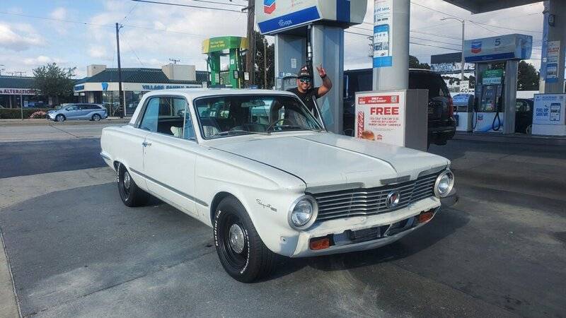

I have driven to Neptunes.
I filled up in San pedro and by the time i got to that first chevron in santa monica on pch i was already at half a tank. And i took the 110 to the 405 so i was at a consistent throttle. I drove to rock store. Then to neptunes. Then home and i used a whole tank. That was before we tuned it this past weekend. I will drive it up again.

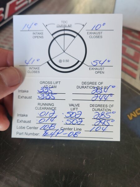

In your case I grossed your cam up to guess at the zero-lash numbers and the formula spit out just 106 degrees. This makes your compression degrees and your extraction degrees nearly identical to mine, with the exception that you overlap is about 67* to my 61*.
I see almost no reason that your combo, being roughly 600 pounds lighter than mine, couldn't out-perform mine in the fuel-economy arena, if we both ran at the same rpm. At that point, the only advantages that I might have is the 3.58 stroke, maybe a slipperier body, and the fact that I run a minimum coolant temp of 207, with fresh cold, above-the-hood inlet air.
And BTW, I run an ancient 750DP Holley that I bought used in about 1977. Notta chance would I, if I had your carb, give it up, no way.
7) Just to give you food for thought;
My previous cam was
276int/115comp/112Power/276 exh/53*o-lap
As you can see the extraction was 112* to your estimated by me, 106*
This cam was 223/230 @050; and it was way more fun than the cam that followed, namely,
276/114/105/286/61* overlap 230/237@050
Your 234/244 has at least 4* more exhaust duration than it needs, and for the lightweight car probably 8 or 10 too much. which at WOT is a maybe a good thing, but those extra degrees are stolen from the extraction cycle, which means, that at cruise rpm, a lotta pressure is going right out the tailpipe.
If I had your cam, I would retime it to 2* retarded, in at 110; But, this will reduce your CCP, which is why I asked for your current compression test results. If you are in at 104 now, going to 110, that represents a pressure loss of perhaps as much as 12psi, which with 3.91s and a 3500TC you won't hardly notice. But with 3.23s and a manual trans, I know is gonna suck.
However the 110 degrees of resulting Power extraction versus my estmated 106, is gonna make a huge difference in the potential to make fuel-economy, after the carb and timing is cleaned up.
I'm pretty sure your combo can't ever make 32mpgs, but I'll bet 20 in steady-state at 65=2400 is doable, and with any 750, and more with a spreadbore with triple boosters.
My previous cam was
