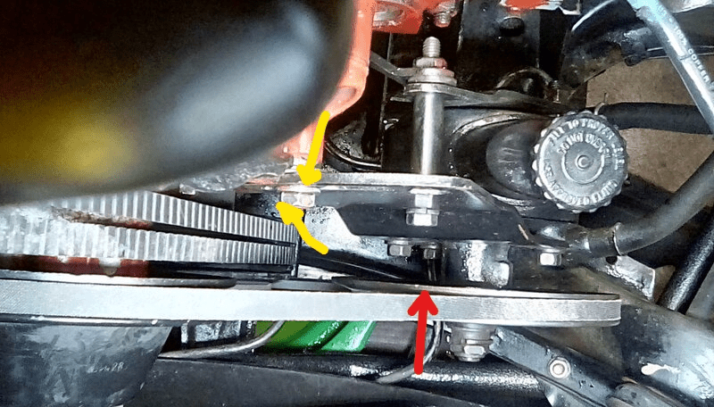

Looking at your pump pic is looks like is lean in toward the motor (Red arrow) Maybe a washer under the bracket on the two bolts (yellow) may set the angle straighter. If it doesn't help you can take em out. Just a thought.
Looking at your pump pic is looks like is lean in toward the motor (Red arrow) Maybe a washer under the bracket on the two bolts (yellow) may set the angle straighter. If it doesn't help you can take em out. Just a thought.View attachment 1715557140
Thanks Kendog. I just put those in. I was just messing around with it some more and with the belt loose and a 1/2 inch ratchet in the adjuster hole, pulled the bracket towards the radiator, made it stop. I shimmed it more in that directions but still squeels. You would think it would get worse.
Edit. I added another washer behind the PS pump and not at the water pump.

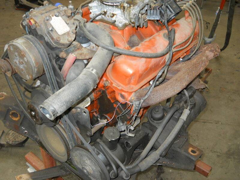

I only asked a simple question. Your answer was sarcastic "see my signature". My input on my setup would have been to offer you the correct parts to fix your car. I have many many parts and a 340 here with AC and PS. I see you have AC and I see you have a saginaw pump. I was only asking the question to help you. Sand blasting your pulley is a temporary fix and only will destroy belts faster. I just brought over 100 pulleys and several pumps home for 340's from a large collection. I could have brought what you needed to carlisle. Have fun its your problem now. By the pictures your assembly is totally wrong. Your missing something can you figure out what it is? Like I said Have fun

I really can't tell for sure that you have the triangle bracket that goes on the two lower water pump bolts. and it looks like your spacer is to short. I have 2 both styles laying on the garage floor I can get pics when it stops raining.
The pics above that I posted are of a 340 with a 318 power steering pump. A 340 performance pump the pulley is spoked not solid. Post some pics of your bracketry. I have tons of parts here and the parts you are missing are yours for shipping cost.
The reason I asked what year your car is ? Spool mount K-members take a different pump. You can put a biscuit style k-member pump in a spool type K car but you cannot go the other way . The pressure line hits the K. If I had what you need I was going to offer my help. I am an old scrooge and take people wrong at times. It doesn't take much for me to ignore some members here as most will tell you. I try and help when I can but I am also still learning I am new to these cars. LOL Steve
