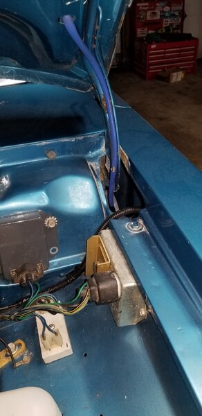

Here's some under hood pic of my 69 B-Cuda Slickback. The wiring as far as I know has never been messed with, and I've had this car 25-30 years.
The worst thing with these turn signal lights is replacing the bulbs, and getting them to work again after taking them apart. They are finicky.
Harrison, you can probably pull the wires thru all the holes with a long stiff wire, or a coat hanger.

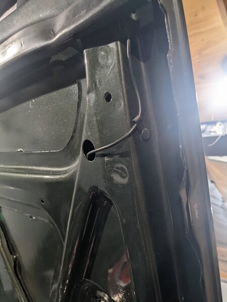

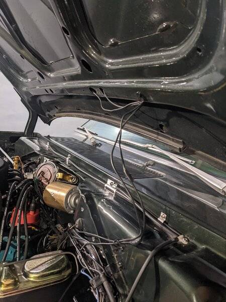

Here is how mine look. Make sure wires are bent in arc so they fold away from hood/cowl weather strip as you close hood. Many decades back mine got pinched between hood weather strip and cowl shorted out and my mother was driving car (decades back these things were just cars) turn signal switch caught fire she pulled into gas station mechanics disconnected battery to save car.

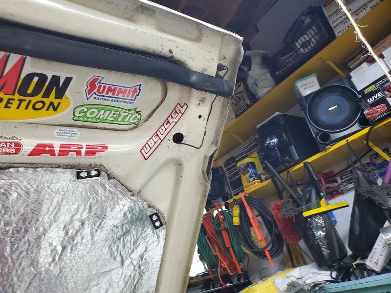

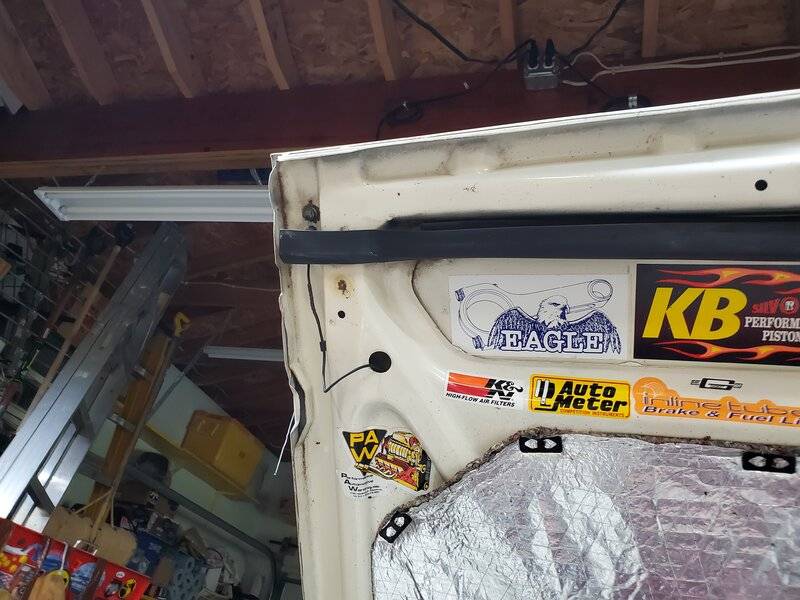

That is like may 68 is. The wires go through the hood inner structure.
