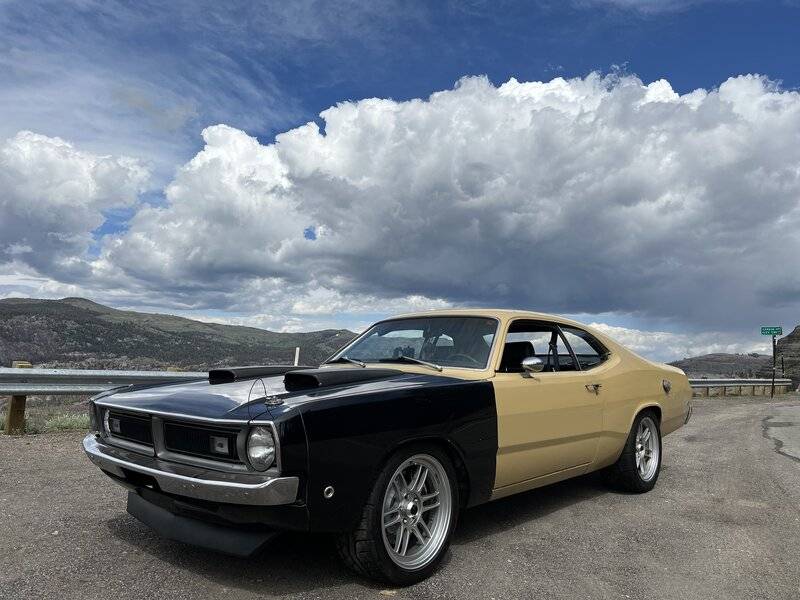

I have a 71 Demon that has been upgraded with bbm axles and 18” wheels. I am looking for that tucked or slightly tucked look. I bought it with 3” raised mopar superstock springs and dont like the stance. The photo enclosed is the look im looking for. I am guessing it is a 1” drop since stock is just above tire

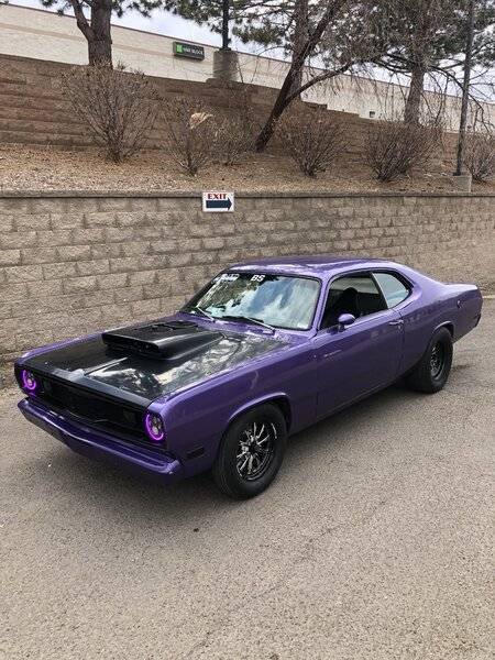

Here is my old Duster with 18's and a 2'' drop 100 lbs increase made by Eton Detroit Springs if it helps.

Keep your original front hangers. The majority of the drop with the Hotchkis springs is from the “geometry correcting” front hangers. So if you install the Hotchkis springs and think it’s too low, you can replace the Hotchkis hangers with the factory ones and get some ride height back.
Just going from SS springs to the factory arch springs is a pretty significant drop.
The rear tire height also has a lot to do with how “tucked in” the wheels look. If you have 25” tall tires in the back it’ll have to be sitting on the ground to tuck the wheels into the quarters.

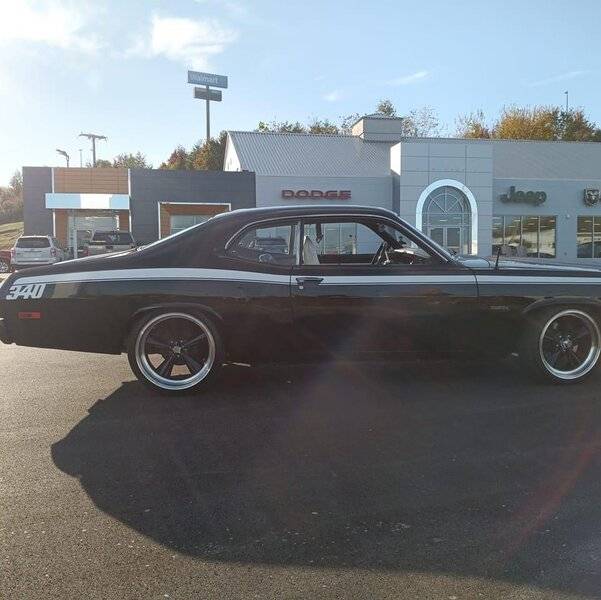

This is my car with a factory arch spring, 27.2” tall rear tires and about a 3/8” lowering from my rear spring slider conversion
Thanks for info your stance looks great too. I also got a fender lip roller to get that out the way, my setup is as follows
Vision Legend 5’s with 4 wheel disc brakes
Front 18”x8.5” - 5.55”BS/+20 offset
Nitto G2 245/40R18
Rear 18”x9.5” 5.72”BS/+12 offset
Nitto G2 275/40R18
