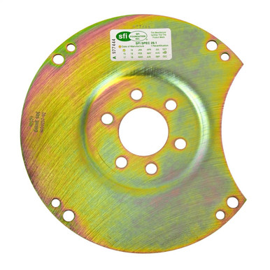

I'm not talking internal balance like with a 273 - 340, the engine would still be externally balanced but with a different flex plate that would allow it to be run with a regular (unweighted) torque converter.Anyone ever heard of this? The shop doing my 360 says it works good. He showed me the flex plate he uses, it has a large scallop shaped area cut out of the side opposite to where the weight is welded on. Claims it results in a better balanced engine b/c using a weighted TC to balance it the "conventional" way isn't as accurate due to the TC not being filled with fluid during the balancing operation.
Sure they've made the modified flex plates for years. I run one on an external balance 400 BB on my race Dart so I can use a neutral balance race converter. They make the flex plates for street and also SFI approved for racing. No problem, I have even measured the level of vibration to 6k with my Bentley Nevada device, and it is no more than the good running 440 I have in a different car that was race balanced at rebuild.

This is the flexplate you run with the larger bolt pattern converter for a 727. The difference between these two Flex plates is the smaller diameter for the 904 so it does not hit the nose of the starter. It can also be used with a 727 with the smaller bolt converters.

For a street engine go with the B&M flexplate. If you build a stroker it would be worth it to add the metal and internal balance. Im not sure how much metal would be needed with the stroker. Mallory metal is very expensive. Hell, even lead is outrageous these days. Has anyone priced body lead recently?
