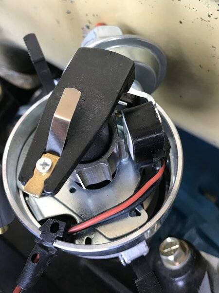

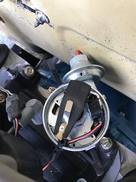

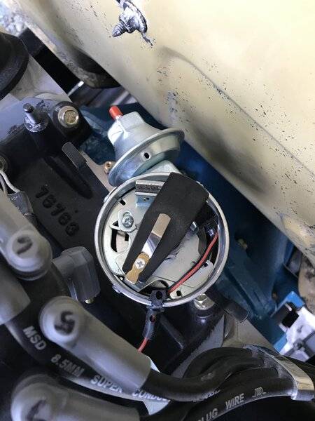

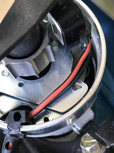

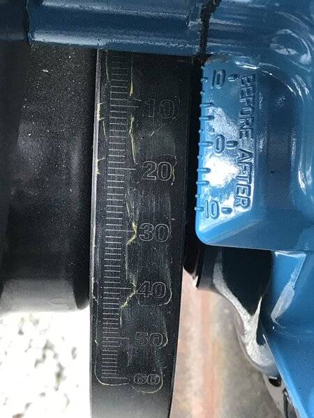

I’d like to post what I got going on with some pictures if the OP is okay with it... @dart_68
@AJ/FormS
Would like you to check my work.
#1 TDC compression.
Balancer is at 15* on the 0 mark on timing cover
The distributor body rotated until Vcan touches firewall.
turn distributor until reluctor tooth lines up with pickup.
Of course this is what the pickup and reluctor tooth looks like with the Vcan all the way back
nevermind the pink mark, I have to jump my wires over one terminal. the orange mark is where the rotor is pointing, which would be #1 terminal now?
It looks to be past the number 1...
am I all chewed up??
@mopardude318 you look to be on the right track. I’ll add 3 things and AJ can chime in on anything else.
1. Make sure you are at #1 TDC on the compression stroke.
2. Moving the vcan all the way to the firewall and backing it up to the closest reluctor is just so you physically have room later to advance the timing if needed. When you start at 15 degrees you likely are only going to move it’s position one or two degrees for idle timing. So a big swing isn’t necessary, but a little swing might be.
3. With the reluctor centered on the pickup, and the balancer at 15 degrees, point the rotor right at the number 1 terminal in the cap. If you have to fudge one way or the other, fudge to the leading edge of the terminal.
