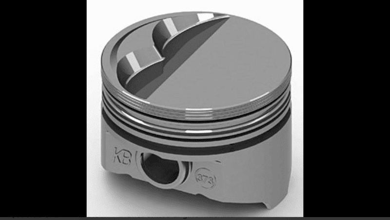

The KB399 has a .200” tall dome that has an effective volume of -6cc.
So, there is an 11cc spread between the two pistons.
Both show a CH of 1.810.

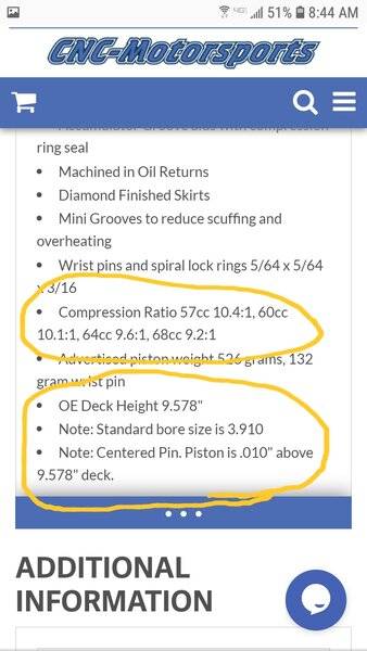

Here is the article I posted above from CNC-Motorsports about the KB399, could be a misprint . . easy to get them mixed up when they are publishing info.
I see there are a few companies showing the same spec info for the KB167 and the KB399.

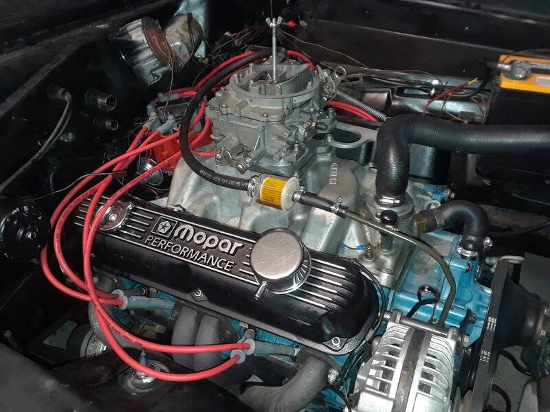

Just picked up a 72 Dart, 318. The receipts show it has the KB 399 pistons at .030 OS. Head casting is the 974 (360) head. Machining shows the block was decked to zero deck clearance. Some porting was done, and the motor sounds really healthy. Almost ready to test drive it, after changing the carb, and fixing the NSS along with a bunch of other stuff. Compression test is showing 170 lbs, not bad for 5400 feet. I'll let you all know how it runs, pretty soon.
