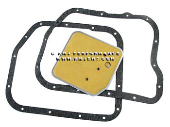

Very, very easy. Get down and look at the passenger side of the pan. The 904 side pan rail is straight along the side, but the 727 has a large bulge in towards the front of the side rail
Here:
727 on the left of the photo
Many filters come with both gaskets. The 727 is on the far right, the gasket actually "upside down" but you see the bulge
Thanks mate, its a 727 for sure, now have to try a get a photo of the shaft to try and work out whats going on.
