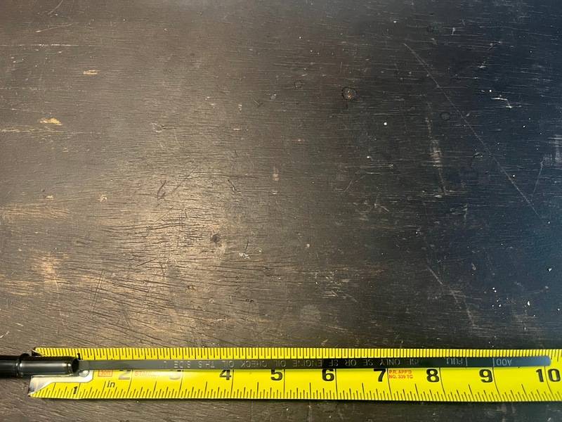

So Does anyone have a confirmed stock dipstick and tube from a passenger car and take a photo like this?
The dipstick pictured below is a cheapie stick from Amazon and it's way off (more than an inch) from when I filled it with 5 quarts and still 5/8 off from the Mopar Performance one.

I know what you want and I have several. I'll check tonight when I get back. I'll take a picture with a ruler and have it on file.

From the upper part of the crushed ridge on the tube to the end ~7 3/4"
Entire dip stick
Close up of total length of the stick measuring surface

Accordingly the answer to my question is that the full mark is about 8-7/8" below the block. Which means the Amazon dipstick is with 8-7/16" the closest to that and I potentially have way too much oil in my engine. I will double check next time I change oil and filter.
1 qt is about 7/16" on the dip stick.
