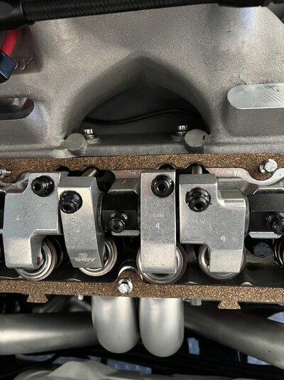

Double check- no, triple check that your valve covers (gaskets) are actually sealing- it's a known issue with air gap style (AG, Victor, S. Victor, etc.) manifolds that they have extra material above the runners (just in case you feel the need to hog the ports out more) and this material can and does keep the valve covers from sealing down like they should along the top of the manifold. Commonly people grind part of the offending valve cover rail away to allow the cover to tighten all the way down, but a good set of valve cover spacers will accomplish the same thing.
Yeah I did grind the valve covers to clear the manifold. Where do I get spacers?
Fel-Pro makes some very thick valve cover gaskets.
Fabricated aluminum valve covers? If you used the bolts that came with, the leak is probably from the VCs.
I found the cheap bolts that came with mine were stretching. I was running them snugged down and was getting oil in th valley. It was only after I actually tried to torque them and one almost broke.
I ordered new bolts, washers and used a ream to open the counter bore up to 7/16 for a thicker ss washer

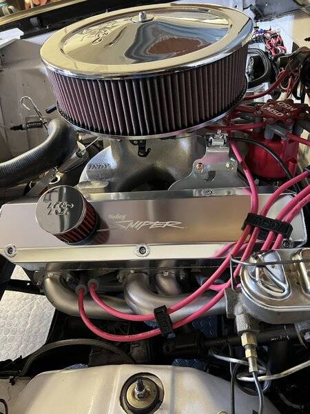

I had a similar issue with oil in the valley. I had installed fabricated aluminum Valve covers on my IMM built 416 with Indy W2 heads. I tried a couple sets, each leaking oil in the valley area after making a pass. Finally found that the valve covers were 1/4” too wide for the head mating surface. Ended up purchasing a set of Holley Sniper covers, which were 1/4” narrower, solved the problem.
