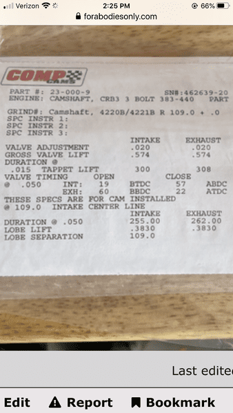

Ok, learning everyday from the Pro’s on here, thanks in advance !
I have a 383/489 with flat tops. I was going to use a set of ported 516s I bought and swap to dish pistons but I just got some Stealths to use instead. So I’m keeping the flat tops. ....
4.5cc, 82cc, .051 gasket and comp roller with ...57* ivc, I end up with 11-1 with 8.33 dynamic.
Chambers may end up to be 84-85 and I’ll use a .040 gasket. Will be using pump 93, in a mini tubbed dart, 3500stall, 4.10s, 28in tire....... Tunnel ram, 2in headers, Street/strip
Cam is supposed to be from Bob Mazzolini’s shop.
What springs do you think I need ???
What do you think of this combo ?
Should work fine.
Very easy on parts lobes.
You could probably get away with 150 on the seat and 420-ish open.
That being said, I just don’t like using spring loads that light in a BB roller application.
I usually shoot for around 200/500 with the milder BB rollers.
I have a generic spring like that here, that installs at 1.900, and is [email protected] lift.
Basically you’re looking for something like a Comp 938 or 954.
Pair with some 10* retainers and locks.
That’s a bit to of a split. 7*’s.
Do you know how your heads flow?
IMO, I think it’s going to be a really nice street engine. It is a healthy cam.
That cam is smaller, and has quite a bit slower lobes than the UD 259/264-108, .651/.651 roller I ran in my old 9.7:1 906 headed 448........which btw was much mellower/better behaved than the MP509 cam.
And....... he’s going to have another 40+ cubes to use it up.
With the slower ramps of the OP’s cam....... it’ll still be kinda lumpy at idle though.
Thanks guys. I didn’t want to wait months for a Cam and then I saw this one on eBay. It’s new and I got it for $300.
The heads are stock, 2 yrs old, with 300 miles on them in a Chrysler 300 with a 383. Will be blending bowls and gasket matching. Haha with all those “300”s maybe I’ll get lucky and they’ll flow 300. Hopefully at least 275

Magnum 262/262 Solid Roller Cam (3 Bolt) for Chrysler 383-440
I was planning to get this one before I bought the other. Same 57* IVC
