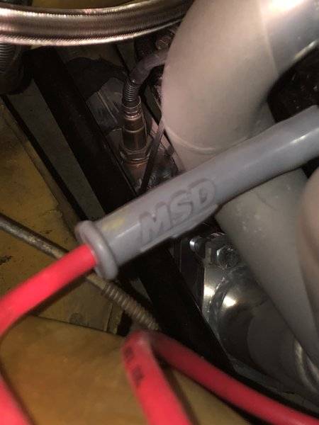

Of course the sensor would be mounted at twelve o'clock, just showing the location.
between 10 and 2 is fine 3 and 9 if there is no other way, it's the same as air/fuel ratio meter

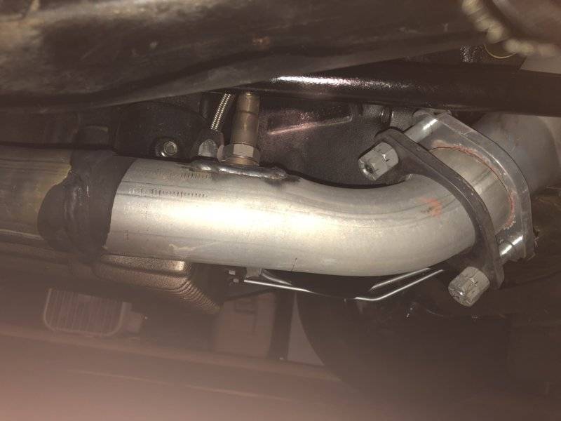

It seems to me that the reason they want it 1-10” past collector is to ensure a good mixture of all the cylinders on that bank. So IMO, headers or stock manifold as long as it is 1–10” past the collector is where you want it. I just made sure in my case that I was in the said range and in a fairly accessible area.
Can I ask which bank you used? I was told to put a bung on each side and see which one is leaner. And to use the leaner side.
If you mean me, I put bungs on both sides, havent used the passenger side yet.
