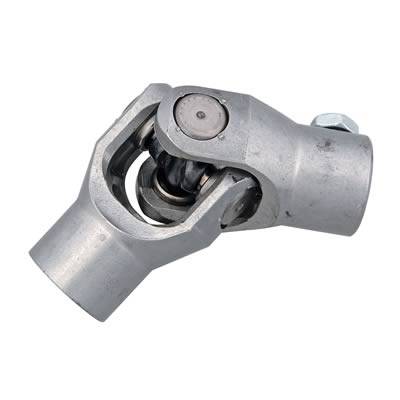

I see that when changing from P/S to manual, an adapter is needed to make up for the shorter column. But when going from coupler to u-joint, people need to cut the column to make up for the longer connection. So, if we change from a stock power steering box to a manual PST one, and get a u-joint, what are we going to need to do to make it work? Also, how do people generally attach the column to the joint? I see DD ends, splined ends, and smooth ends on Borgeson universal joints.

When I went from power to a non power box I used a universal steering u joint. I think it was a 3/4 36 spline to 1' ID smooth ( measure what you have). Once measured out and mocked up I welded it to my steering shaft.
Thanks for posting the pics. I just tried attaching my pst adapter to my coupler. i could not fit the two pieces together. any info would be appreciated. thanks
