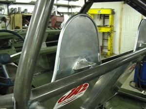

Anybody have pics of their racing seat brackets?I,m looking for some pics of brackets from the race seat to the back bar.Rules state 6 inches,can they be made adjustable?Lets see what you have?Thanks

Yep, that's what I made, you don't think I paid $45 DOLLARS for that do ya.
The 2 Tabs weld to the cross bar and the bracket bolts to the back of the seat then to the tabs.

Heres mine .I made it from an old shock plate (that i cut in half) ,and a piece of scrap tubing.Worked out well for my "shade tree engineering" and the seat is rigid as can be now .Been through tech at a few tracks with no problems and cost me excactly $0.00 in materials to make...
Thanks Shocker!Finally a pic of a simple setup and cheap.Will be making my own for safety.Hey Green,read some safety books?:read2:
No problem .Lots of things would work as well ,but i chose the shock plate because it was laying around on the floor and it already had holes drilled in it for the bolts (im too lazy to drill holes if i can avoid it ).I have the other half of the plate if you want to make you one ,lol...
Thanks anyway:toothy10:I have the Metal Supermarket around the corner,can usually get cut-off pieces for free.Free is good McGyver!LOL.Ihave seat and harness brackets already,should be a breeze.:-D
