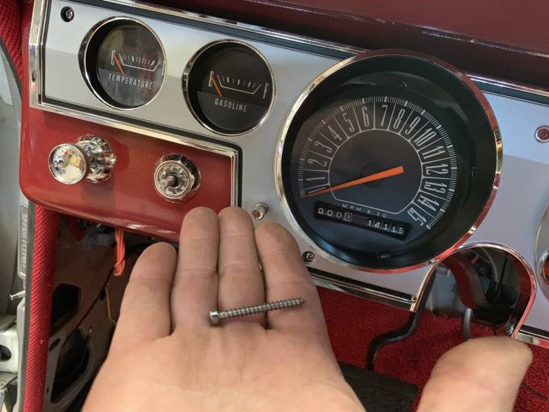

looking if anyone has a picture of the correct screw and size used for a dash cluster in. 66 barracuda?
I’m getting to reinstall a new cluster bezel assembly to my painted metal dash and want to buy the correct screw to mount the dash cluster assembly to the metal dash board. (Cluster to bezel all set) My old one was damaged by previous owner using the wrong screw damaging the bezel.
This is the screw you will see when driving.
Thanks!

#10 x 1-1/4" chrome Phillips but the head is smaller than a standard screw.
I think this is factory but seems longer than necessary...
I found them in a screw kit I had bought a while back. Only needs qty 3 Chrome headed Fillister with philips head. #10x1-1/2”.

SN: not a new cluster but a reworked cluster by Instrument specialties in Rhode Island.
