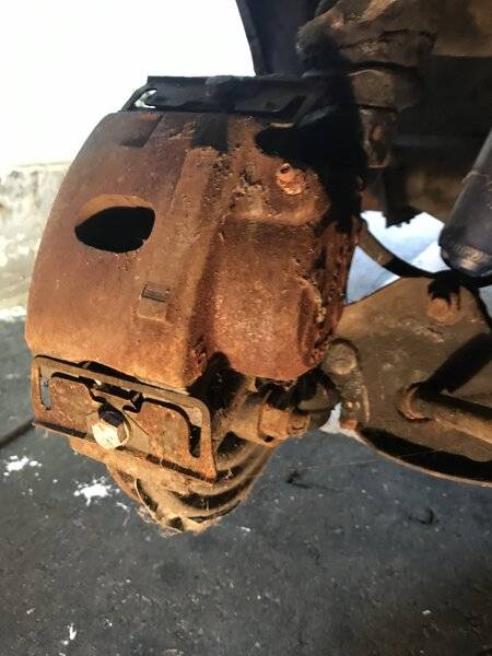

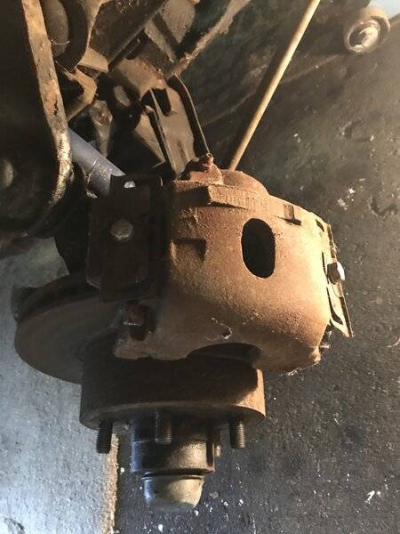

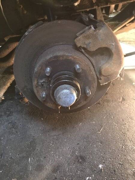

Subject vehicle: 1967 Barracuda
Can you tell me what year the brake calipers are from based on the photos?
Thanks
They look like 1973 and newer big bolt pattern. Not sure what body but they look the same as my brothers 1973 Duster. Bobby
I’m glad to hear that. It should be easy to source calipers and rotors when I need them.
Appreciate your reply.

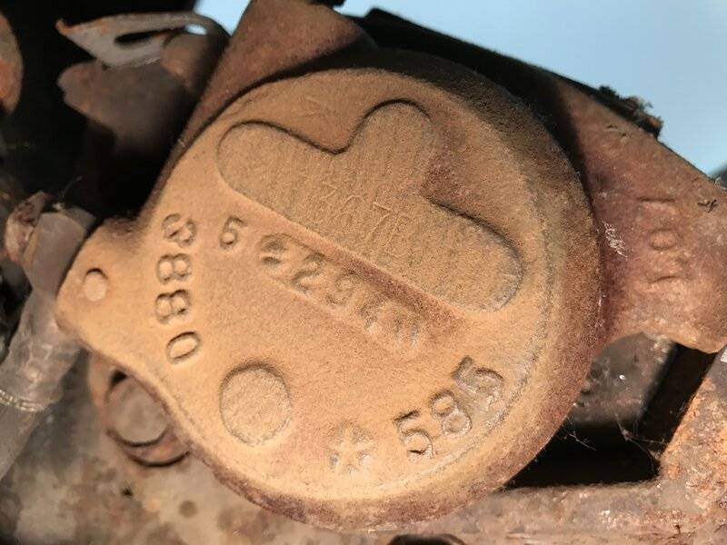

Does anyone recognize the numbers 3880 585 on the caliper ?
Thanks
Make sure you check piston size. They of course must be same left/ right. My understanding is that the ?? Coroba etc will also interchange but have larger pistons.
Yes, the '73 and later A-body 'sliders'. You can use A or E or B-body (11") rotors of that era.
Thanks for your reply. The guy behind the counter at my local parts store says he thinks it’s Cardone # 18-4103. I’ll find out if he’s right in a couple of hours.
