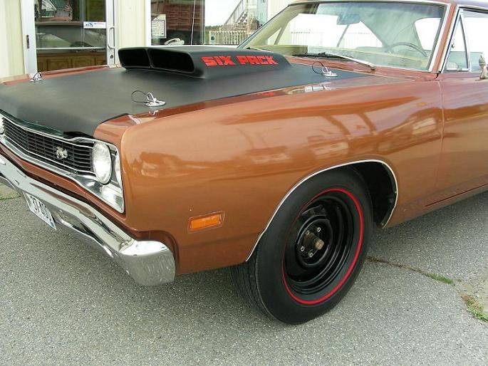

Its a shame no one has made a radial that looks like a poly-glass. They would sell like hot cakes.
BFGoodrich makes a red-line radial.
Doesnt have the same square look as a poly-glass though.
