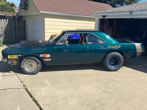

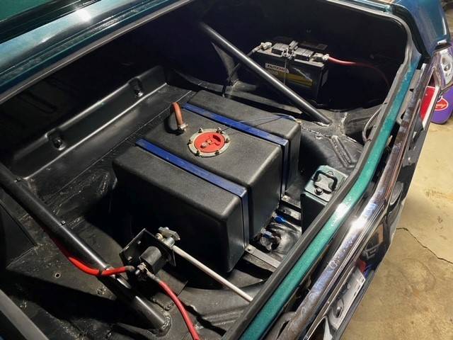

15x10 with 4.50 BS
29.5X10.5X15 Mickey Thompson (still lots of room)
Previous owner bears all the credit for the tub and moving springs in. He had 14 inch wide slicks on it with 12 inch rims and 6 inch BS
Swapping in a dana 60 at the moment.
