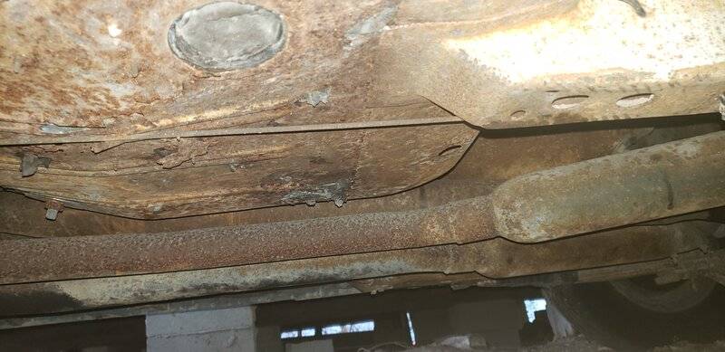

Before I go down that rabbit hole I'll probably get someone who knows more about body work than me to check it out but thought I'd throw some pics up here, too. My main concern is the condition of what I guess are like frame rails with this being a unibody car. There's at least no through hole rust that I saw so I'm hopeful it isn't a lost cause. I was sort of surprised to see there are separate front and back rails as the only other unibody I've worked on they run the length of the car. I guess the floor plans are basically holding the two ends together? If so, I need floor pans for sure. And will probably weld the front and back rails together just because the two halves thing weirds me out. That just seems floppy.

Already in your pics I see rusted out floors which is probably just the tip of the iceberg. The more you open up this car, the more you're going to find. I'm afraid you're going to end up hating Mopars when you discover the large amount of money that it is going to take to fix it and make it safe. I hate to discourage you, but I think you would be better off starting with a little better first Mopar.
That's a barracuda with a 63 Valiant front end on it. 7th picture down there's a big rust hole in the floor.
If the frame rails are good, and the torsion bar cross member is good you're way ahead of the game depending on your willingness to tackle the sheet metal body work and your overall goals for the car.

Honestly it looks like a good start. Mine was just as rough, with some exterior sheet metal needing replacing too. Frame connectors are a must in my opinion, and rockers need to be sound as well.

Your frame rails look to be good, with just some surface rust. Sure, you have some rusty floor pans....but that's the case with the majority of early A bodies, along with rusty spare tire wells. Look for front fenders and hood from a 64-65 Barracuda, or from a 65 Valiant. 64 Valiant fenders were different. A barracuda grill is much different, and every now and then they pop up for sale here. Expect about every center grill section you find for a 64-65 Barracuda to have broken top mounting tabs. That's nothing that can't be fixed with some same thickness aluminum bent to shape, and some Fusor body panel adhesive. If you're into the car pretty cheap so far....go for it! It appears to be a good car to learn on, and hone your skills with. I see you're in Charlotte. Any relatives in the Asheville/Candler, NC area? There was a guy named Gene Cline on the track team with me in high school.

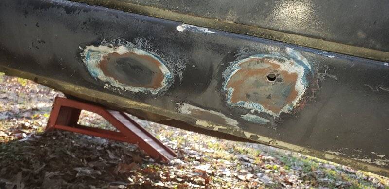

So to follow up. I dug into the body some with a wire wheel on an angle grinder. The frame rails and rocker panels seem quite solid. But the sheet metal has at least as much filler in places as expected. Mostly above the rocker panels. If I'm not shooting for perfection, or even necessarily good as far as matching the original shape of the metal, if I just cut all that out and weld new panels to the rockers and wherever the good metal above them starts... that should get things to structurally sound, right? (Along with rail connectors and new floor pans.)
Andrew, as stated before, Its up to you how far your willing to go. Mopars aint cheap and early A,s are worse. The parts are out there you just have to hunt them down.64,s and 65,s have more parts to find and better than one year specific like my 66.
Donor metal and 20ga sheet metal will be your friend. There are quarter patch panels available and floor pans. The frame rails and most of the underside look good. You can make your own frame connectors on the cheap.
