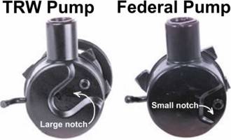

The earlier ones have TRW or Federal pumps. I have a TRW in my 68 Dart that I upgraded from manual.
