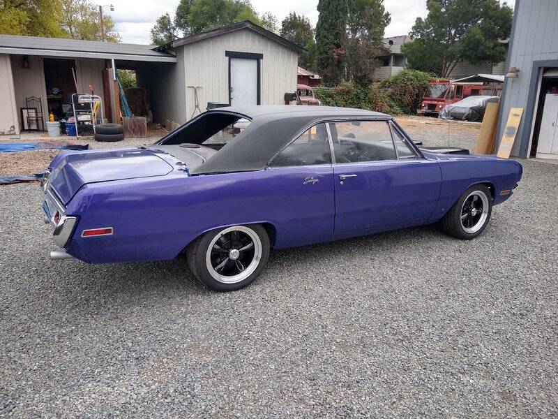

The car has been painted and clear coated (finished almost a year ago). I am adding a vinyl top this weekend. What's the best way to prep? I am thinking just a acuff with grey scotch brite to dull up the clear.
I am going to use DAP Weldwood Landau top glue.
I would sand with a little more than a scuff pad. I hit mine with 220 to knock all the shine off the clear. Stay away from the edges other than a light pass.

Thanks, working on a 70 dart. My dad is going to help, he has done two before. I'm gonna scuff it and tape where the trim goes on Friday, so we'll be ready to go first thing Saturday.
Ok, all done. It wasn't bad at all, except the sail panels, that was a two person spot for sure. I still have a little trimming to do, but need to buff the trim first.
Now what's the best compound to keep this baby looking nice?
Yeah its not as bad as people think it is. The sail panel area gave me trouble along with the strip below the back window. Other than that it was a breeze to install. Did you get the seams nice and straight / centered?

Yes we measured from the seam to the gutter on both sides amd front to back. Then clamped it half way and worked it half at a time.
