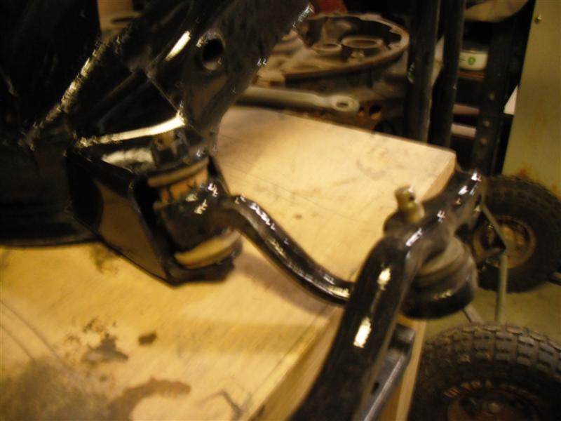

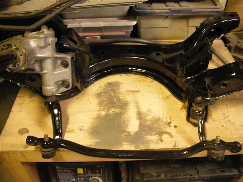

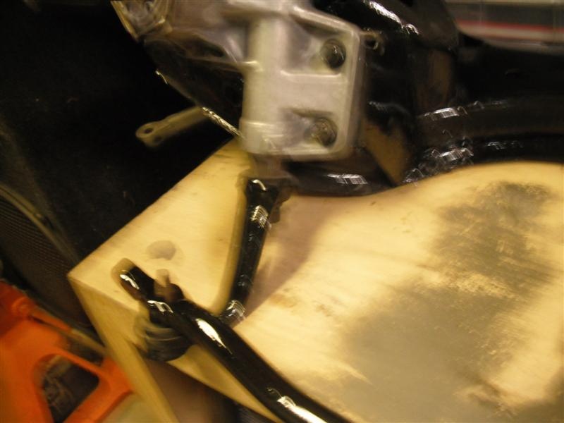

Ok I found a receipt that the guy had in a book he gave me with the car. It had was from Napa and had a P/N of 242-3011 for the calipers. A search on Napa's site and Google didnt turn up anything. I was trying to figure out what year and type of car those came off of. I also found another receipt for tie rod ends that he bought specifically for the 71 Scamp.
So the tie rods are correct to the car, but the idler arm is not. Im just stumped as to what this guy may have done. Thinking this might have to go on hold until I can look at the car again. Sucks having it so far away.
Does yours look like this? If so your original is a K7086 and it would be correct for the OEM 73 through 76 big ball joint A bodies.
That is exactly what the one I took out of my car looks like! If I understand correctly, someone prior converted the center link to 73-76 style?

That is what it would appear since that idler arm matches yours. I am very interested in seeing your pictures. Your parts could be off a 73 up and bolted to the original K frame from the sounds of things. The pictures should tell the story when you get them posted.

Steve that is great! Thanks for the pics! Like I said Im just waiting for my pics to arrive. Although I think we figured out what is going on with it.
tie rods are the same..
just get a idler arm for a 73+ A body...you dont need to change out drag link
