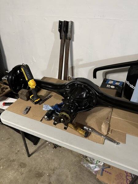

Thank you to @mopowers for teaching me how to build the 8 3/4 center section. We almost got it done, tomorrow I will go over to his place to finish up.
I was dying at the end there, good time to call it quits!
Shoot, when you look at it, we were at it for about 4-hours. It'll be done in another 30 mins. So, 4 hrs 30 mins (half of which was spent bs'ing), start to finish. Not bad for a couple of boneheads without the 'proper' tools.

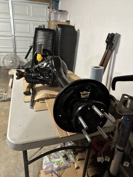

Very big shout out to Cass, @DoctorDiff. I ordered some custom length axles for my 8 3/4 Tues 7/18 at 11 am PST. They were on my doorstep today when I got home. Just in time for my birthday tomorrow. I was definitely surprised they showed up so fast.
Happy Birthday, why did you order it with long wheel studs?
Happy belated birthday. This project has been great to see, inspirational to fuel me/ others! Thank you for sharing your journey with us! Takes me back to high school and midnight mania on my Valiant.
Happy Bday Jared! Looks like a good productive day before it warmed up. What's up next once the rearend's in place?
Thanks man! I’ve got the gauge cluster that needs to be finished, epoxy, paint and it’s done. I want to start on the metal work soon, but it’s so damn hot. Then it’s wiring, motor assembly, 4 speed/clutch assembly, and the final mechanical piece will be a driveshaft. Seems like a lot but I’m just plugging along.
