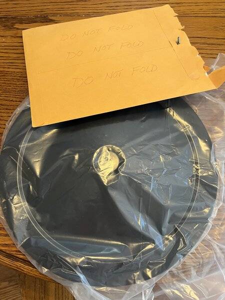

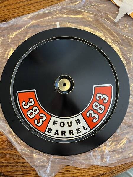

Got some small parts today. I didn’t want to spend $200 plus on a factory BB air cleaner. $40 for the jegs open element with K&N style filter and $11 for the repro decal. I think it looks great!

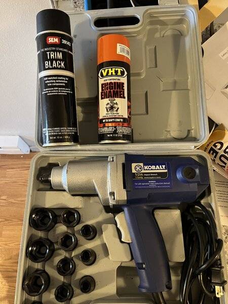

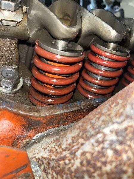

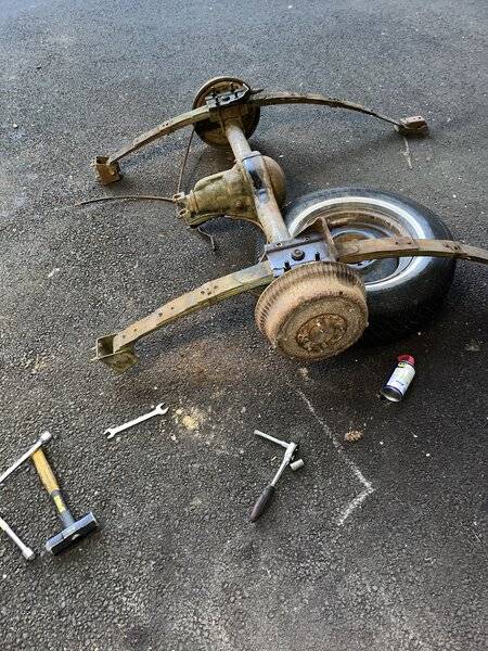

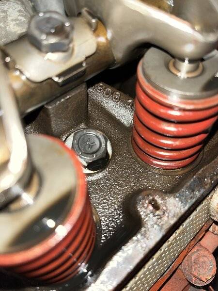

Somewhat of a fail tonight. I only got one of the old springs off. No power tools,no air compressor, and no sawzall made this job suck. Tomorrow I’m buying an electric impact or a cheap air setup.

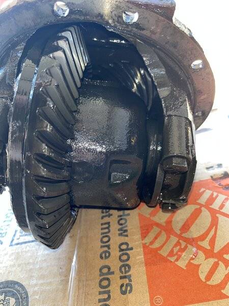

You asked about the Sure Grip you got. It is the best Dana/Mopar clutch type that is rebuildable.
We called them V Ramp. As torque is applied the clutch engages per the V.The more torque the tighter the clutches grab.

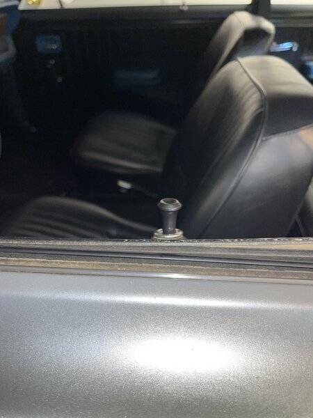

Added a new glove box insert today.

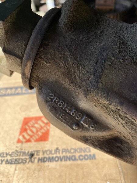

That's strange, I always thought the early '70's C body rears, along with all year wagons, had the good axles. Obviously something is up with that axle as the 489 carriers came with cone type sure grips ( except for maybe some very early models) and you certainly seem to have the clutch type.
The 3rd member I posted is a new/rebuilt unit. I pulled an open 2.76 489 case out of the Newport rear end. I was surprised about the tapered axles as well, but I don’t mind buying new strange axles.

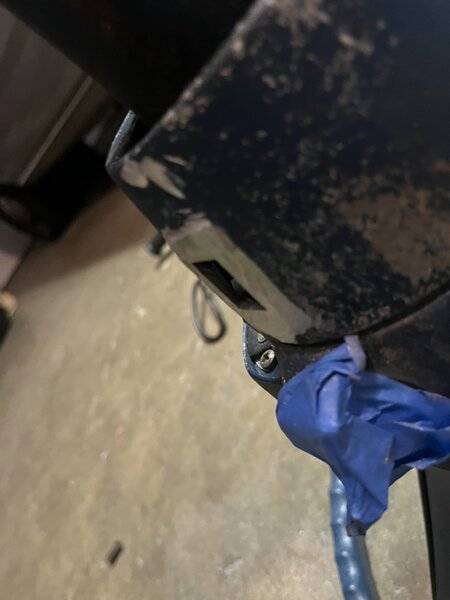

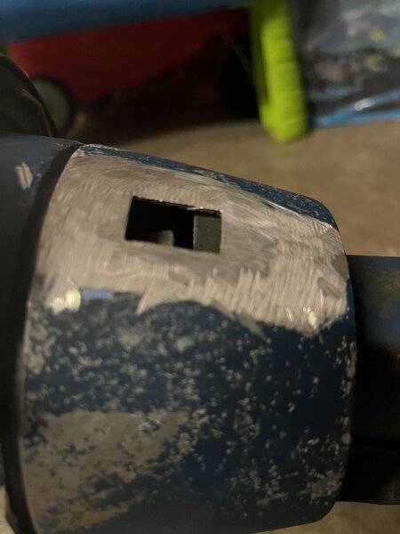

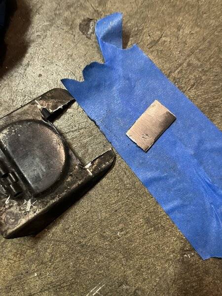

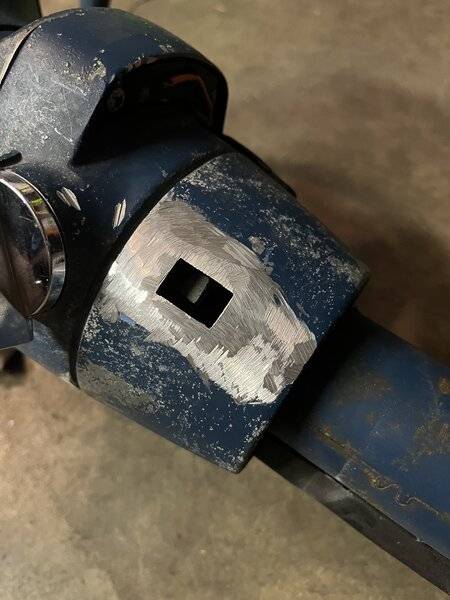

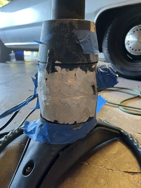

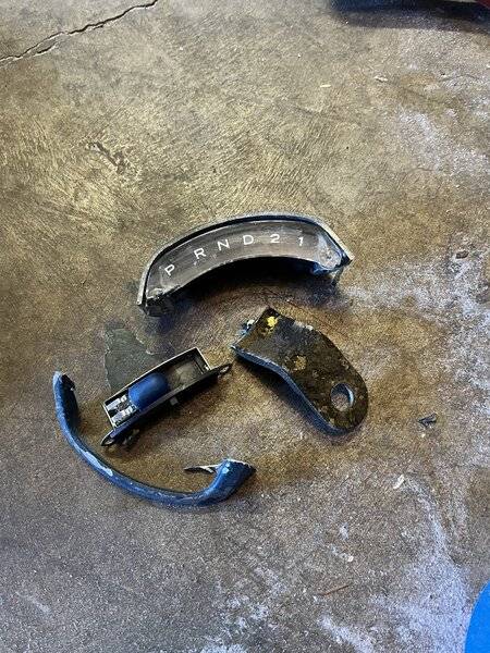

Took a grinder to the steering column. Cut some stuff off. I kept a defunct air flapper door out of an old slant six air cleaner for some reason. Well that reason was to make a patch for the shifter hole. I’m going to jb weld that into place.
I need to do some hand sanding to smooth out the grinder marks. Depending on how smooth it turns out I might just paint it and call it good. If it’s all wavy gravy then I will hit it with some filler, sand, then paint.
I’m considering hard mounting a mini tach where the shift indicator used to be, it would save me from having to do too much to it.

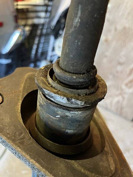

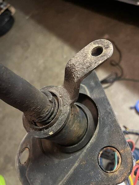

I also cut of the arm for the column shift to trans. I just rubbed some of the old grease on it to prevent any flash rusting. I will be cleaning this area up and doing the bearing upgrade before the column goes back in.
Traded the 2.76 3rd member for this today. I’ve got some 3.73 gears for an 8 1/4 now I just need a sure grip and an install kit. Gonna run it until it breaks then upgrade. Should be half the price of modding the Newport 8 3/4. Yeah I picked it up in my Sentra.
