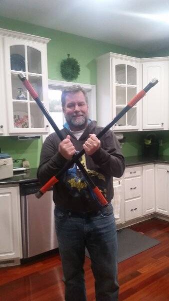

No clue. I'd think just a tad heavier being thicker? I didn't weigh them, just guessed. I might be stronger than I feel....lol
