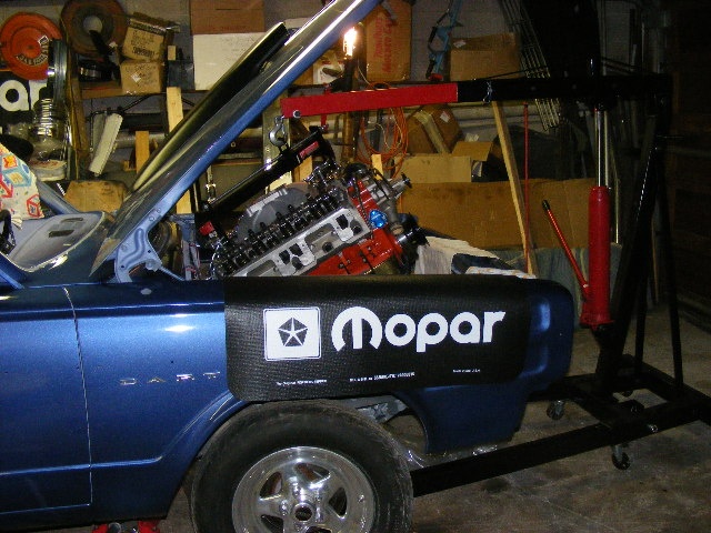

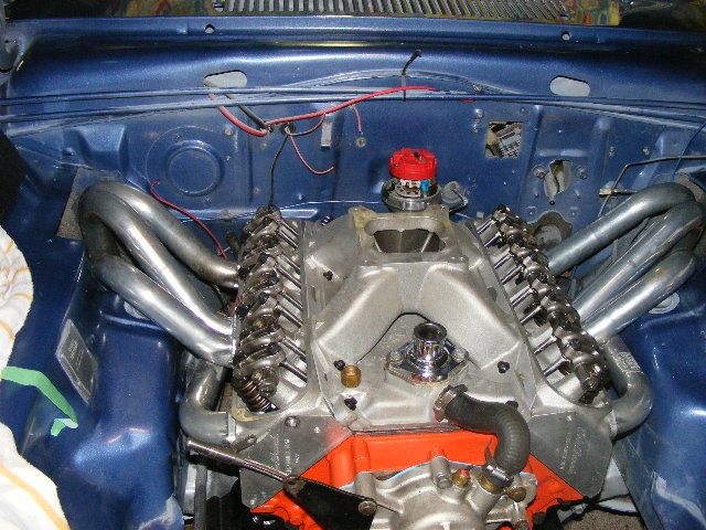

I got the heads torqued down, rockers torqued down, rockers adjusted. I just need to gasket match the new intake & put that on and its ready to install! I also ordered the torque converter today,,,,, ouch!
Looken good :toothy8: who's rockers and shafts are ya runin?
before you put on the intake...
make sure you lube up those lifters if you havent already :D
put white lube or assembly lube on the cam lobes and the bottom face of the lifters (not a ton of extra white lube just a thin layer on the surfaces that touch)
the sides of the lifters that touch the bore... put a bit of motor oil on them if you want so they are not dry in the hole.
77 360 block bored .040, Scat 4340 4" crank, Scat 4340 H-beams, Probe Flat tops(12.5:1), Comp solid roller(269/[email protected] .654/.655 lift), ported Performer RPM's(287I/205E), Comp Pro Magnum roller rockers, Edelbrock Super Vic intake, 950 HP Holley, Hooker 1 3/4" Super Comps. I ordered a Dynamic Frank Lupo 8" 5000-5100 stall converter($1K). Engine is backed by a 727 w/ 2.77 straight cut low gear set, 8 3/4" w/4.10's. Our race season starts in mid May, so I hope to have it close by then. Also switching the rear leafs to a Chris Alston Ladder bar/coil over set up.
Sounds like a beast build!Good luck getting it setup for May,I hope to be out for some T&T in a couple weekends.:D

Ohhhhhh Petty that intake needs some LOVE in the plenum area!! At least you guys are puttin' engines in your cars....:-(
Yeah,plans are for a port matched Victor in the near future when money reappears in my wallet LOL
