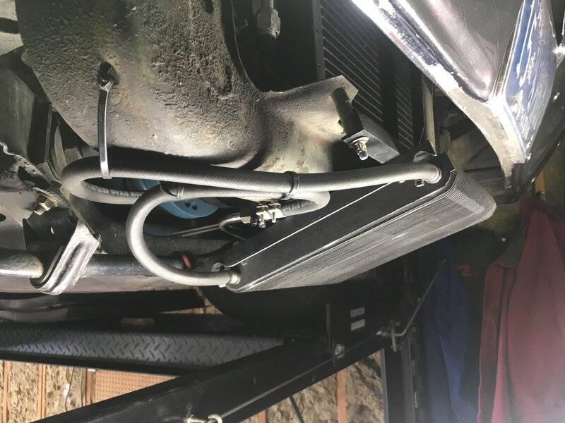

I have A/C and I decided to keep my transmission cooler out of the air flow into the condenser and radiator.
I instrumented the oil in and out lines and even in stop and go traffic the cooler is cooling around 5 degf and driving it cools the fluid around 20-30 degrees
