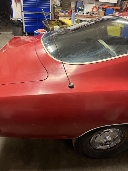

I recently bought a 67 formula S barracuda fastback off of the original owner, and he has the original bill of sale, dealership paperwork, brochures etc which is great.
The radio antenna on this car is on the top of the rear passenger side quarter panel.
This is an unrestored car, and clearly has never had an antenna on the front fender. I asked the original owner about it and he is 100% certain that the antenna was exactly where it is now the day he bought it at the dealership.

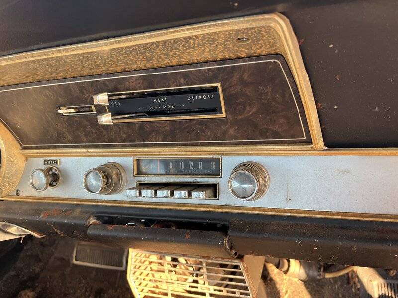

This car also had the original AM radio and has never been monkeyed with.
Did antennas ever come in this location when new?
Interesting that it never had one on the front fender, as I’ve looked at it from the underside to be sure.
I’m guessing the dealership installed it then
Can't say they didn't do something different for the Formula S but the 67 sales brochure shows on the front fender

Does the passenger side front fender have an antenna hole and or a delete plug? If not someone has patched up the hole I think all the fenders came with the antenna hole in them unless maybe it was radio delete when ordered.
Hold on I did a little digging it may just be a factory rear mounted antenna
read up on this and see if it’s plausible. Scroll down to the paragraph on antennas.
Definitely original front fender, and it does not have a fender antenna hole like every other mopar that I’ve owned over the years.
Thanks for that link cudascott; mine is indeed a Canadian car so that holds up with what the guy wrote in the link.

If there is no radio code on fendertag, then I would assume dealer installed. If dealer installed, then it's on them as to where they installed it. Is that dealer air? May explain why antenna on rear 1/4. Once you get under dash you will realize how crammed it is.
In the dart FSM there is a template to make to cut the antenna hole so I'm guessing the on a radio delete car it would have gotten a fender with no hole.
In 67 the Barracuda didn't use the antenna delete plug, holes were punched after the fact.

That car had no factory radio/antenna, hence no hole in the fender. This was installed by the dealer.
