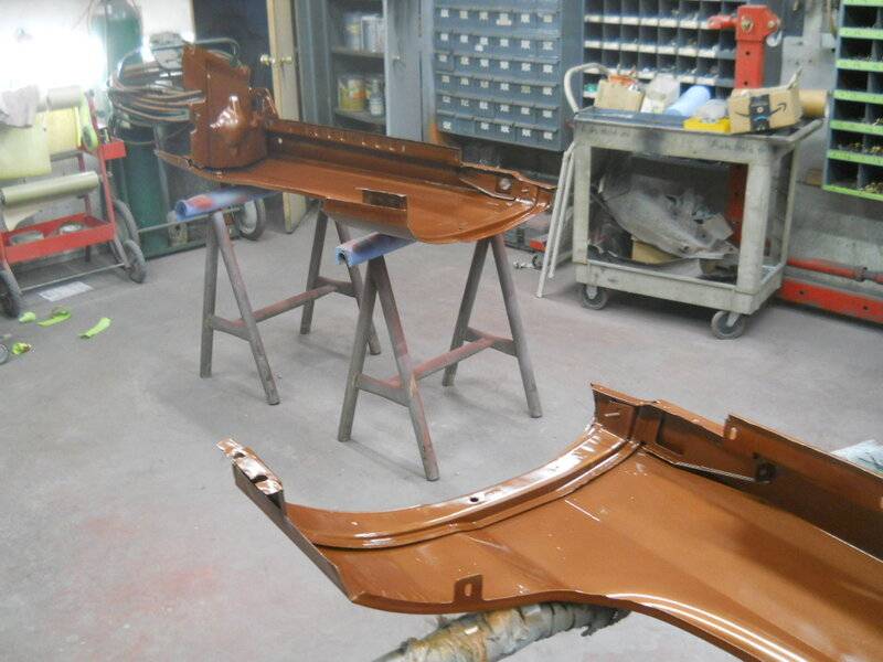

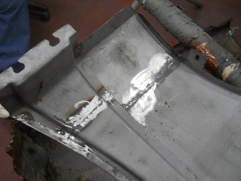

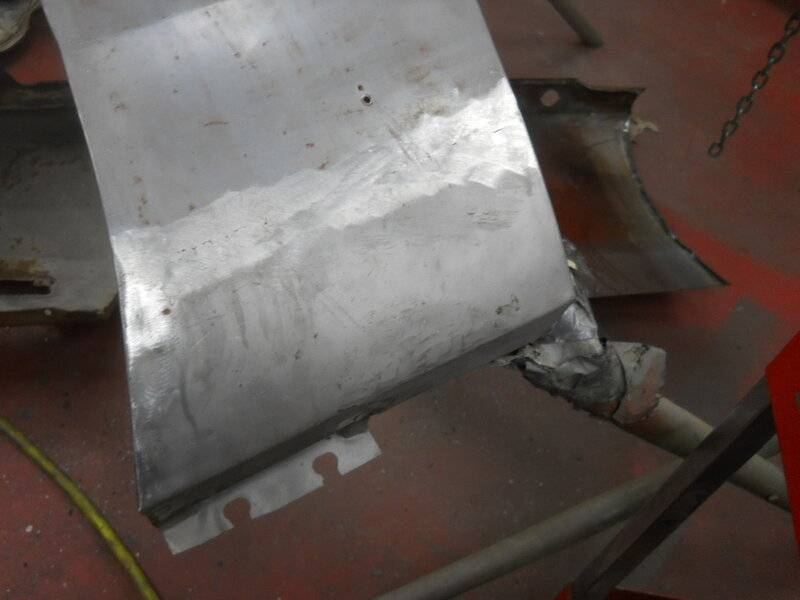

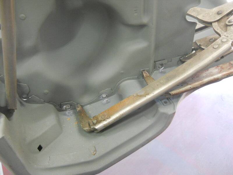

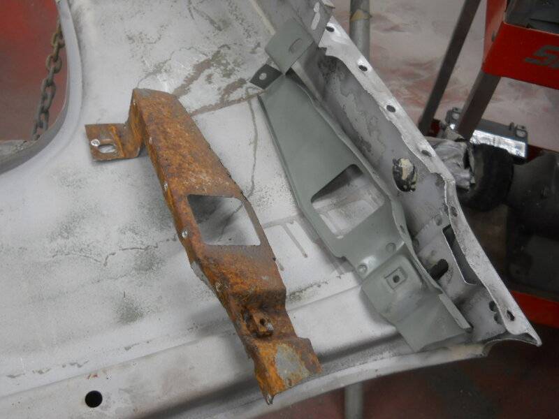

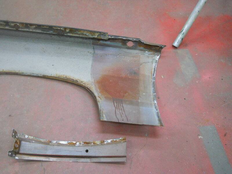

Using your existing fender you can make any fender work. They spot weld drill apart and can be made to fit what ever you want
