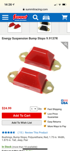

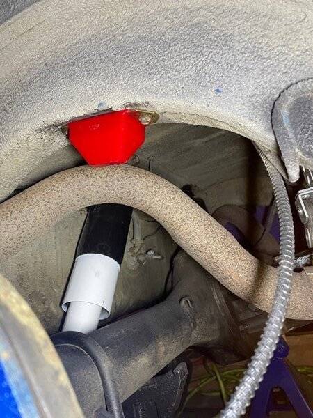

I had been searching for a while for some replacement axle bump stops. The ones on my Duster were still 1970 originals and pretty dry rotted. I wasn't having much luck finding any until...recently. These are made for a Jeep of some kind but they bolt right up with no modification. It's probably old news for most of you, but I figured that someone might benefit from the information.
