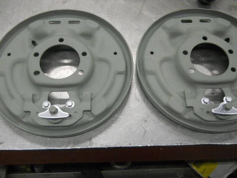

I have some rear backing plates I am not going to use. How do I tell what they fit? They are the five hole plates so I know they at least will fit the 8 3/4 and Dana. Thank you drive through.

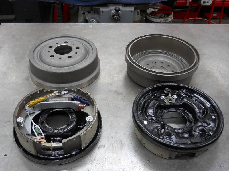

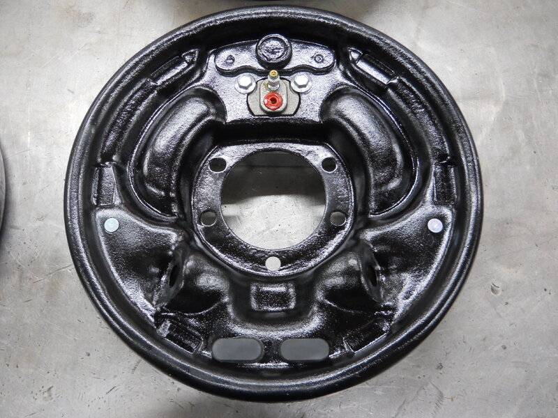

first picture is small bolt second is Big bolt , Notice the difference in the depth below the wheel cylinder for the axle flange. Big bolt is much deeper. If you post a picture I could tell you what you have. Last picture is front small bolt
