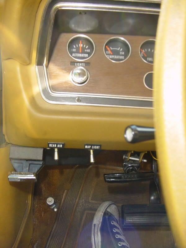

Has anybody got a 67-69 A-body with a rear window defogger, especially one in a car that has the map light feature? Can you show or tell me the position of the on/off switch and/or it`position in relation to the map light switch? This is for a 68 Barracuda but a Dart or Valiant would be fine. Thanks.
I stole this pic from 73scamp(IIRC):

It's in the same place as the convertible top switch. Since you can't get a power top and a rear fogger.
