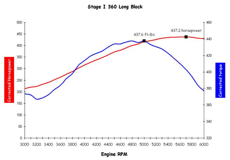

Here's something like mine (which I rev to 7000 all the time); You'll have a wee bit more on the bottom,there; and a lot more on the top, and peaking a little earlier,probably. If you plan to regularly visit the 6400 plus region, you need to do some oiling mods.
This curve was with an HE3037AL 230/237/110cam, NA of course.Here's the link.
