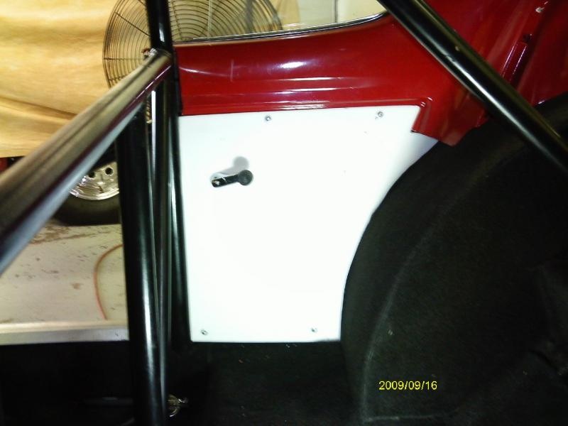

I got some rears from the Help Section at an auto parts store, make sure to read the package and get the "Mopar" ones. I had to get some and then cut them off and reinstall the knob in order to clear a roll bar. The wing window handles would be nice if you can find where to get some.
here's what mine look like. The vent window winder has a tapered counter bore where the correct window winder has a square bottom counter bore. easy to alter though.
