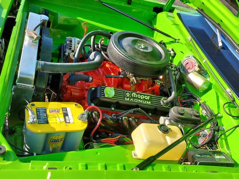

my plan is to get a Modern 4 wheel disk cylinder, add adjustable proportioning
Valves to front and rear lines
Yes i know that Sound excessive, Im
Setting up for Road Racing. ill put front and rear brake pressure gauges inside
So that I can adjust the braking for the specific course , least stopping distance etc

I use later masters such as this one. This one is an 1-1/16" bore. Dr Diff sells a 15/16" bore. I just tee the front lines and an adjustable valve for the rears.

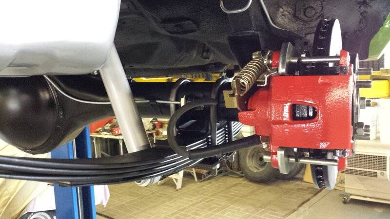

I have the 73-up factory fronts with the 11.75 rotors.
MBM rear disc.
Will probably be changing to Wilwoods and put this setup on another car.
Flaming River 16.1 manual box. Setup for street and road track like yours.

These are the prototypes of the MBM rear disc. I helped them design the Mopar setup and they gave these to me.
